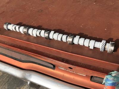

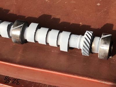

There is a specialty tool used to ream a cam bearing. I have also heard of people using an old camshaft with a cut in the bearing journals to ream in new bearings.

The 440/495 in the red car and 383 in Jigsaw both had tight fitting camshafts that required clearancing with this:

Yeah, diagonal grooves were cut into the journals of an old cam. This was covered in chassis grease, inserted in the block and spun several times. I'd pull it out, try the new cam for fitment and if it still didn't spin freely, I'd put the cutting cam back in and spin it some more.

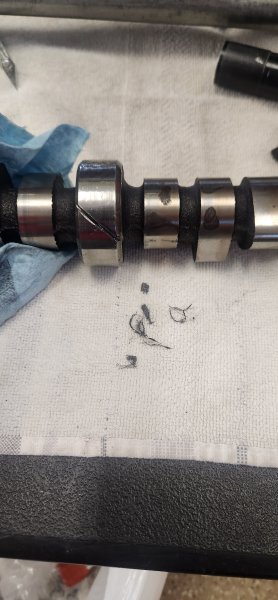

Bearing bores have gouges, raised metal around the drilled holes, etc. I usually ALWAYS have to scrape the bearings to get the cam to fit. One trick I do is to use a ball hone on the bores before the final wash to knock down as much as I can and sand/file any bad spots. The bearing will show the high spots so scrape, test fit, rinse & repeat until it fits. And, under NO circumstances use any sand paper on the bearing.
Scraping works find the shiny spots an do a little and fit. It's a slow process. Using an old cam with slits cut in each bearing journal at a forward angle works slick. Press and rotate. It''ll trim off high spots on any one of the five journals in one swipe.

Cam was tight after new bearings in my 383, I did the old cam method Kern Dog mentioned, worked like a charm.

"Tight cam" is a common problem. Usually I blame myself. Maybe I hammered it in wrong and "mushroomed" the bearing opening. Even though I cleaned the bore good and oiled the bearing bore and the od of the bearing in hopes of it going in smooth. Now I have to take a bearing knife and feeling with my finger and scraping the front of the bearing until I can get it in. Sometimes trying to put the cam in and turning it back and forth to put a shiny spot on the bearing to help me find the high spot. It's a tough job.

The cam bearings have the same centers as the cam so it starts into all the bores at the same time so figuring out which one is tight is challenging enough. The cutter cam is typically the best solution.

I cut a slot in an old RV cam. Put it in and rotated it. It is amazing how much material came out. Put the roller cam in and it was still tight. Put the reamer cam in again and more material came out. Put the good cam in again and still tighter then I am comfortable with. One more time with the reamer cam and rotated it several times, pulled it back, cleaned the groove and rotated several more times. Now the roller cam goes in and turns easy with just a little help.
