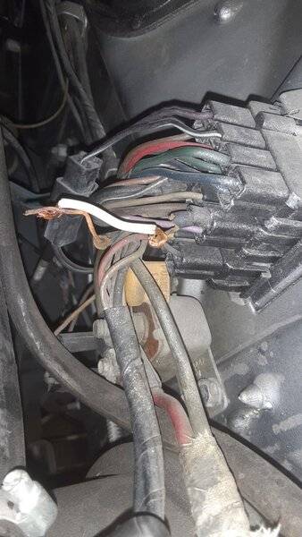

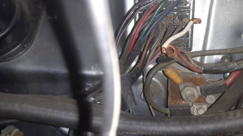

The wiring at the bulkhead looks pretty hinky but if the spark plugs are getting spark shouldn't it be okay? It Hasn't fired one time.
Here is the bulkhead wiring. I don't know what that little white jump wire is for. We didn't put it there. Do you see anything we should check?

What's the deal with the white wire at the bulkhead connector? Your mechanic has a spark on each plug wire?
View attachment 1258232 View attachment 1258231
Definitely figure out what that wire is through a wiring diagram ,that's a fire waiting to happen.

Just wondering if that white wire was put in because the fusible link wire burned. I had that happen on our 70 Superbee, it wouldn't start and I found the ignition switch came apart and shorted inside on the steering column. I don't rhino the Chargers switch is in the column but the wiring there doesn't look good.

We haven't checked each plug/wire but more than 2. Agreed the wiring doesn't look good. The switch is in the dash. Was the mechanic right about the compression stroke? I hope so. Remember it was running but barely when we parked it.

Stay focused on air/fuel/spark as that is all what it needs, regardless of wiring quality. (but you need to sort that out later for sure)
