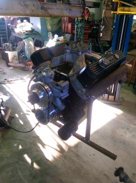

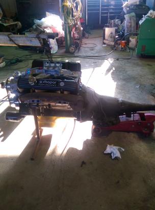

Today was the day! After the build, we decided to rig a cradle and another old 727 and put it all together outside the vehicle. Thought was if we had leaks, etc. much easier to get to outside the vehicle rather than if it were installed.
Rigged up old radiator with electric fans, oil temp gauge and water gauge. Instead of the headers, used a set of hp manifolds for break in.
After figuring out why we didn't have spark (clip wasn't connected tightly) she fired right up! No leaks! Very little tweaking and ran great. Louder than crap with open exhaust. Sounded great! Lol
I added a couple of pics.. Tried to upload a short video but no luck..I'll try to figure it out. Probably wrong format..

I've wanted to build a test stand but haven't got around to that yet. Nice work.
Thanks. For this one it was very easy. Just the stand in the front of engine. Attached to motor mounts. Once we attached the trans, we just propped that up at the correct angle. If we were going to build more engines, then we would have done a complete cradle front to back. That would have taken more time for sure!
As for engine still a little more carb work. Idles a little high and can't adjust down. Using Holley 850 dp. The floats were a little high, which we fixed and helped a little..still have work to do before final install.
