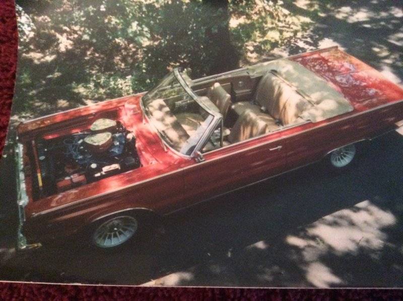

I’m pretty sure from seat of the pants feel that my stock 67 440 GTX with 3.55 and slightly looser torque converter will smoke my stock 66 Hemi, 4-speed off the line up to some point. But the Hemi pulls harder and harder the more it winds out.
I've also done the "all 8 Barrels in" in my Coronet a number of times..... (when I was much younger) , and each was an insane experience.... thrilling, and more than I care to explore now, at my advanced age!
