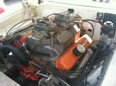

So lets see,compare a pump gas wedge that is street driven to a 600+ inch race hemi for track use:thumbsup:
GO AWAY!
And i'm comparing it to a 498 pump wedge . So stay out of it.
And BTW , what experience do you have with Edelbrock carbs?

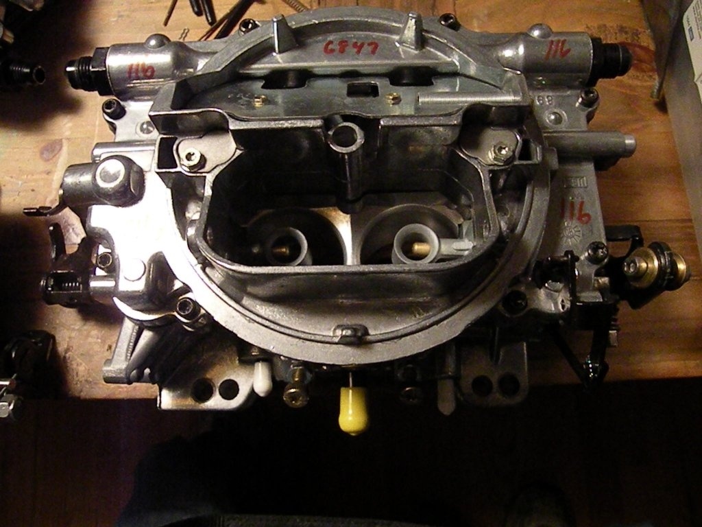

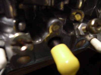

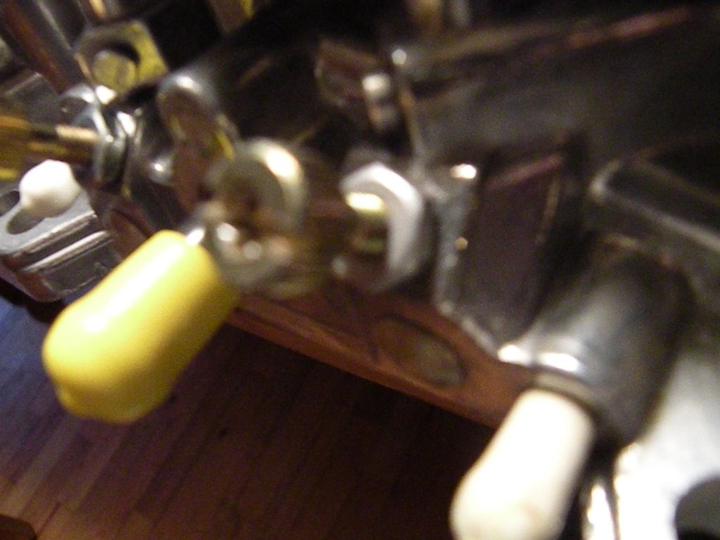

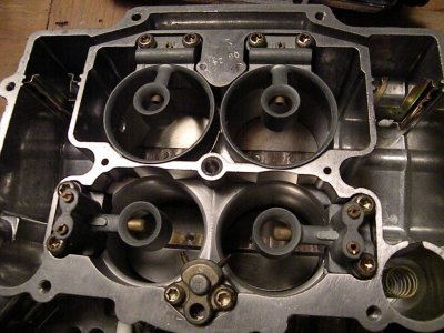

Check to see what metering rods you have in there and report back. You should never be able to load up a pair of these carbs if set up correctly. Also, turn in your air mixture screwsall the way in and back them out evenly 1-1/2 -2 turns and go from there.
Thanks superstockracer. I fiddled around with my idle screws via vacuum gauge and it likes 1.5 turns out. It will idle down to 900 without loading up, but have it at 1000. Been too busy to check metering rods but hope to tomorrow.

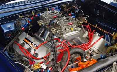

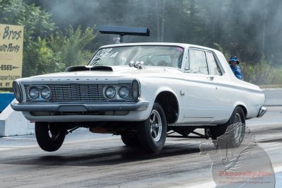

Great first outing. Try to shift next time out to 6000 rpm's. I don't think you need to wind it up that high.
I shift my 498 CI max wedge to 6000 to 6200 maximum with a .650 lift cam. No need to go that high since, i bet your peak hp isn't at 7000. Try it out. I've tried ever shift combo and found to go fastest at shifting at 6000.
