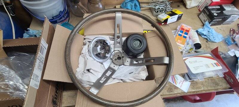

Thanks for the detail YY. This isn't a "GM wheel" per se. It's a universal wheel (no-tilt) with a 3-bolt pattern. Talked to Summit and confirmed compatibility with the proper Mopar 3-bolt installation kit. Fingers crossed.

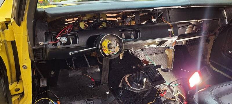

For the steering wheel debate, the vintage 1970 wood, sport wheel does not work with the pictured 1972 steering column in my 1970 vert.

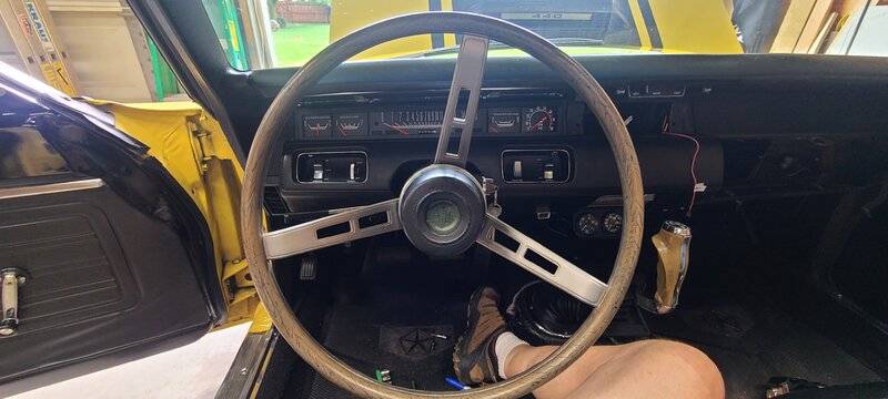

Big shout out to Tony's Mopar Parts! There's a key spline on the wheel that I was unaware and of course the orientation is way off from where I'd prefer but the '70 vintage wheel does absolutely mount to that '72 steering shaft. Took a bit of love to get it lined up & started but it did go on once all I had a clue on what was required.

If your tires are straight, then you have the steering shaft inserted into the steering coupler on the gearbox 180° out. You will have to pull your steering column out to fix the orientation properly. There is a notch on the shaft and a notch on the coupler, all should be at 12:00.
Lol, I did that once.
To the op, if the coupler is oriented correctly, then the steering wheel will get straightened out with tie rod adjustments when aligned.
