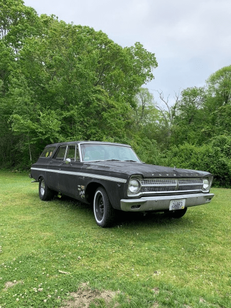

Well some of you know about my 65 Belvedere (Creep) wagon. That's what the wife calls it. Anyway it's a project and I had a lot of fun driving it this year. Since the trans let go after a trip to an Anthrax/Hatebreed/Black Label Society concert I've decided to upgrade. As far as I know the engine and trans have never been out of the car. That's a pretty good run. I bought a 79 360 and started gathering parts. I am also going with an A727 instead of rebuilding the original 904. I'm going for the oldschool dragstrip look.

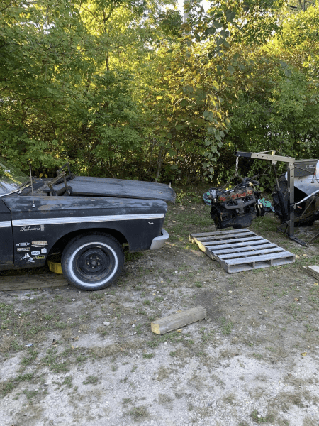

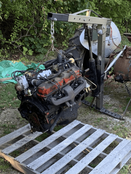

Today I got my grandson to give me a hand. We pulled the tired 273. I welded an engine hoist on the back of my old farm tractor and it made for a pretty easy pull.

nice, I wish I would have thought of that rigging when I pulled some motor home motors!
I did have to add a 40lb dumbell to the front for added ballast weight. So far so good. I haven't tried a big block yet. Might have to add another 40lbs for that.

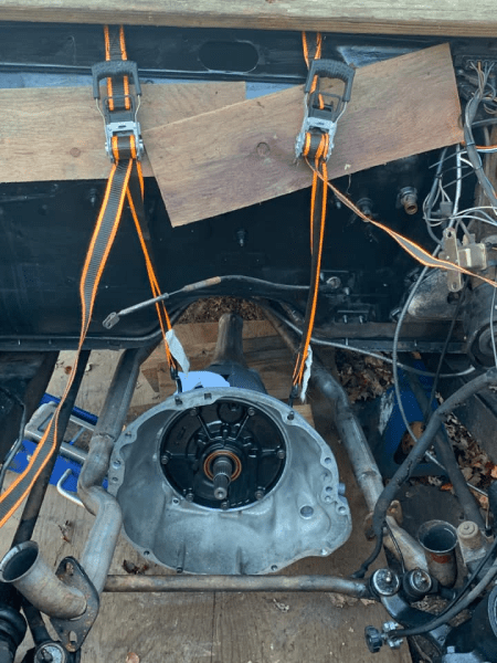

Since I had no help and the grandson was sick I decided to man up and get the 727 in myself. 2 ratchet tie downs and my floor jack did the trick. Crossmember with the new adaptor trans mount are bolted in. I hope everything lines up with the motor.

Love the 3-point engine hoist set-up, that looks like a 8N tractor? I have a "49" 8N, might have to build a rig like that!
It was really easy to set up. Just a couple of steel plates at the top mount and welded the bottom to a spare draw bar.
