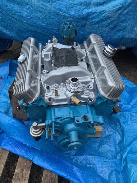

I got the 360 back yesterday and started some assembly.

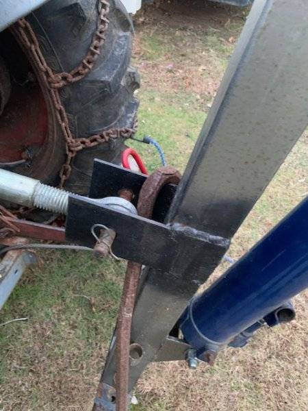

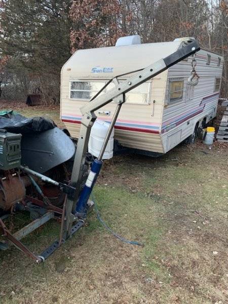

Love the 3-point engine hoist set-up, that looks like a 8N tractor? I have a "49" 8N, might have to build a rig like that!
Here's a couple of close-ups of the hoist set up. Very easy. I welded to the lower drawbar and welded plates up to connect to the top mount. That was pretty much it.

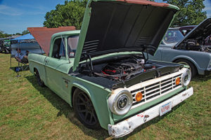

The V10 Viper truck in question. A good friend. I helped him out when he needed an extra hand. Now he's doing all the metal fabrication and bodywork on my 69 Dodge Dart with a 440 big block.
