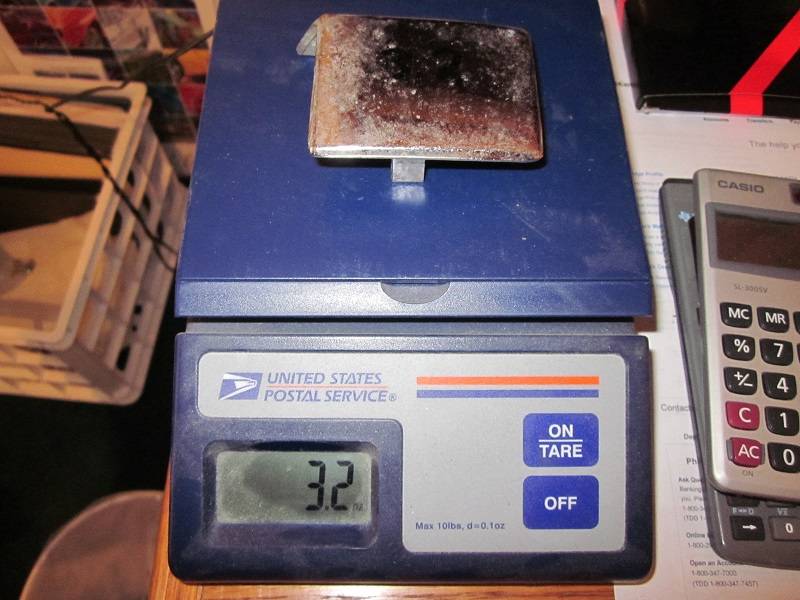

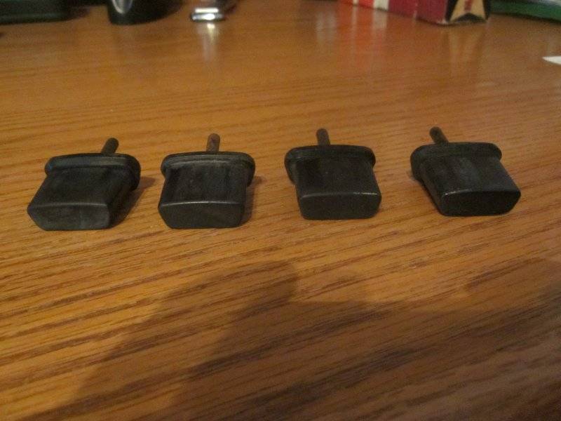

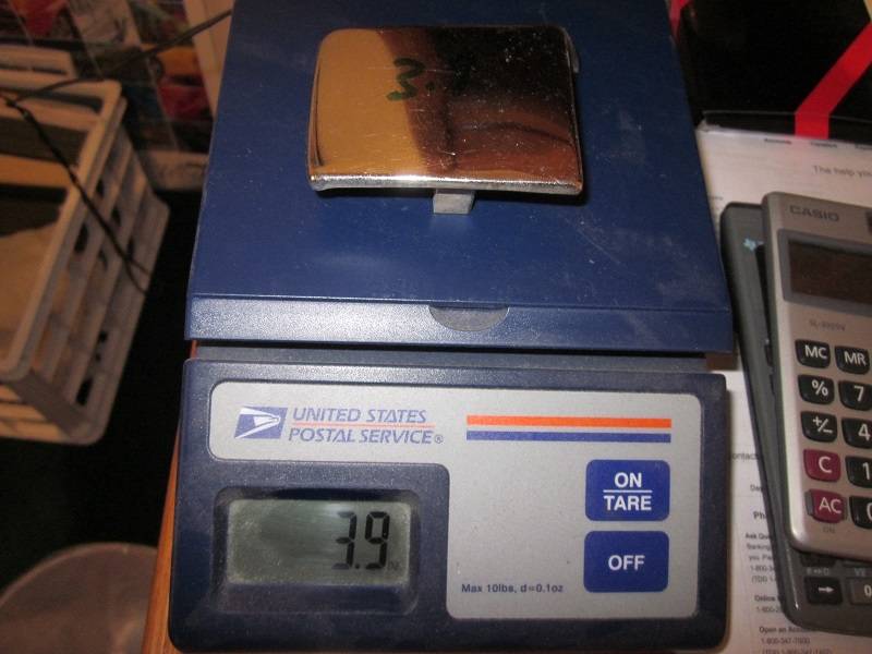

It is ironic that you used the door buttons as an example.
I have 2 pair of these for sale over in the exterior parts for sale section!

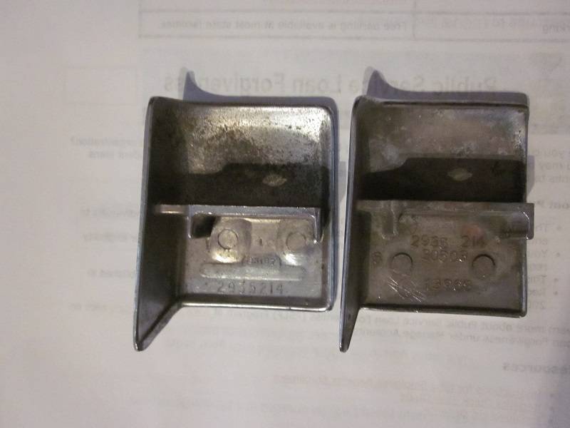

One thing I would like to mention here is that Chrysler had multiple suppliers on almost all the parts.
I had an advantage of having boxes of original parts from parting out midwest rust buckets years ago.
Now with the AMD sheet metal there are no more parts cars!
So an example I would to share is inside door handle pulls.
I got all mine out and weighed them!
They ranged from 3.9 oz to 3.2 oz and when you look at the back sides you can see the difference in the castings!
You can even clean up some of the mold plugs for more!
MJ

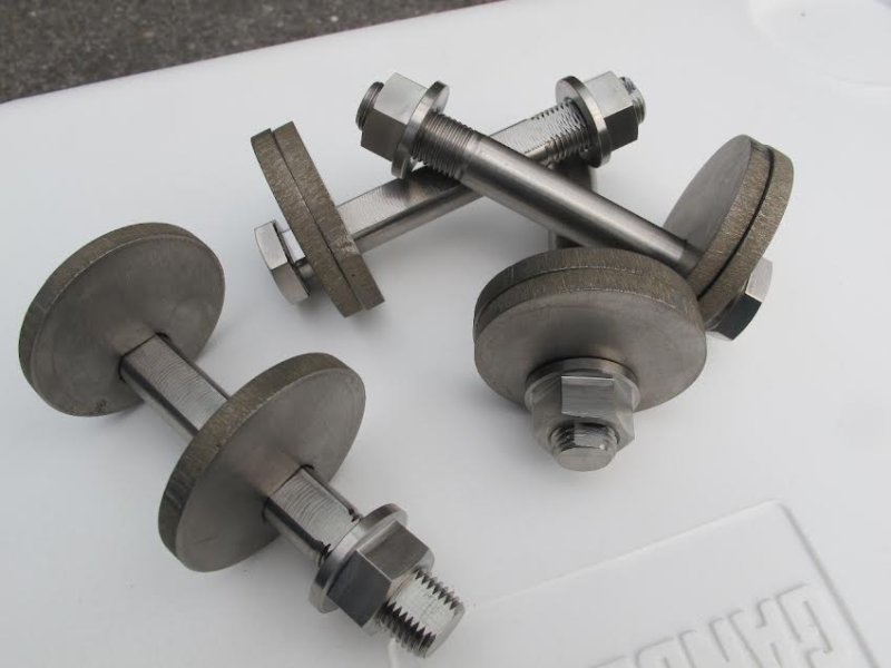

I honestly can't recall a car at the track with a stock starter for years..Lightweight MOPAR starters!
1) does it crank over your race engine with no problems?
Thanks for the reply!I just ordered one from 440Source. I'll let you know what I find out.

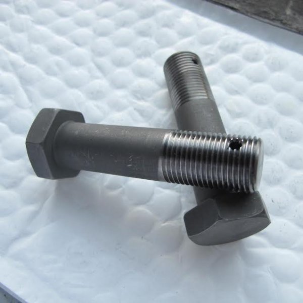

These shave 1 pound and 30 grams. 6AL4V TitaniumLots of weight a guy could trim off a starter
Thank you.That is so sneaky (and awesome).
Kudos, my friend, Kudos.
