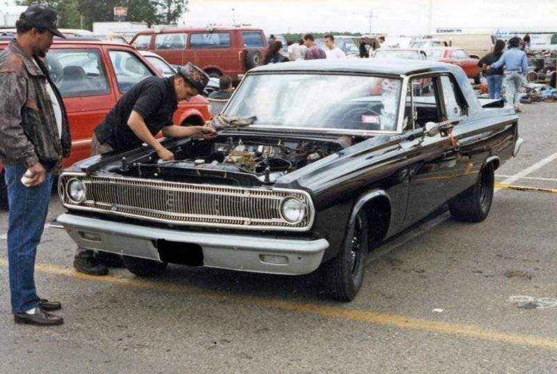

Going back to region #1, the hood is the obvious first target.
Most cars should lose it (like the one pictured below LOL) It's the first thing we see since it sits high on the body and takes up a lot of real estate on the very front of the car. It is arguably the most changed body panel when it comes to weight removal. There are of course a few variations of ready made catalogued hoods out there made of fiberglass, carbon fiber, but hoods could be made weightless by utilizing exotic alloy materials or by chemically milling the original hood.
