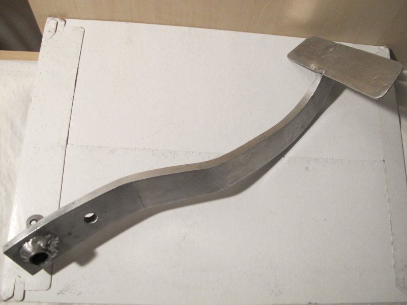

The stock brake pedal lever weighed 3 Lbs without the rubber sole pad.
Here's the 6061 aluminum brake pedal lever and foot pad before paint. It weighed 1-3/4 Lbs without the rubber sole pad.
It saved 1-1/4 Lbs.

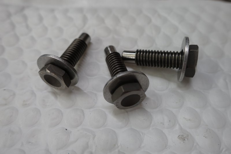

Here's the special machined 6AL4V titanium brake pedal swing bolt and nut assembly complete with aluminum lock washer. It all weighed 1.70 ounces compared to the stock one that weighed 3.25 ounces. It saved 1.55 ounces. All of this unseen. Now you see it because you never saw it before.
and the tricks just keep on coming i love it
Ha, the bag of tricks is endless.

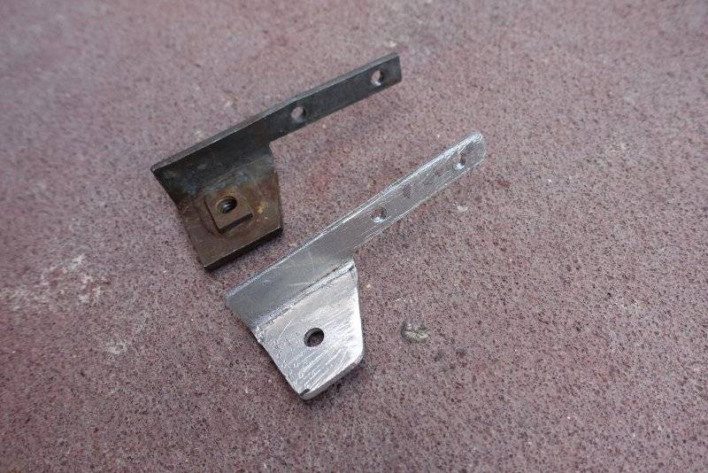

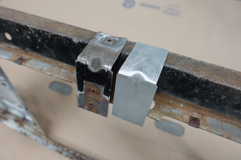

Here's a little simple dimple detail upfront at region #1 by the radiator support. Still haven't installed it since life gets busy sometimes.
Perhaps I'm just wishfully thinking of fetching one of those A-990 thin gauge radiator supports.

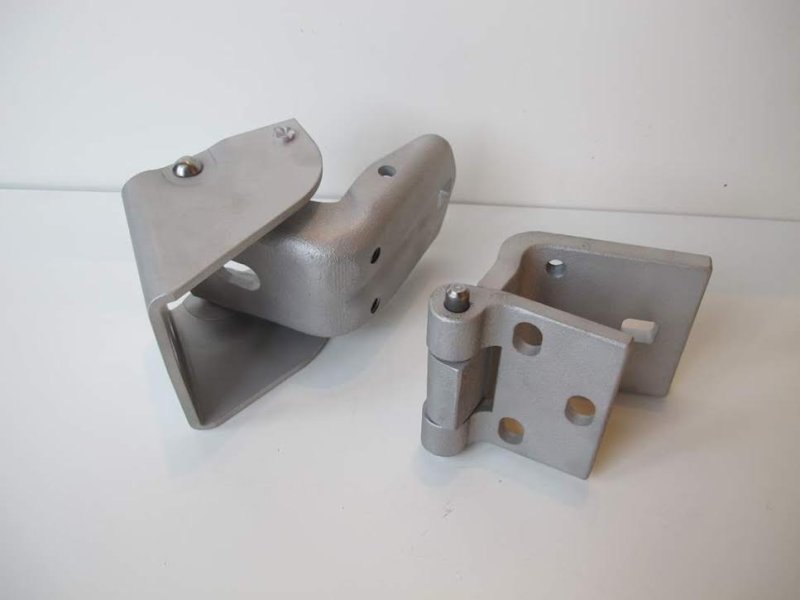

Starting with Region #2 at its very border with the firewall, the factory door hinges, at least for the early '64-'65 B cars, weigh 11 Lbs without the fasteners. Unless a rare pair of the original '64-'65 Hemi package aluminum hinges happen to be burning a hole on your shelves, there isn't much of anything out there that is lighter.
Believe it or not, even more rarer are the reproduction aluminum hinges here that are carbon copies of the Hemi package types since less than a hundred pairs were supposedly casted and assembled. The pair weigh a whopping 4 Lbs.
That being said, some guys here have painstakingly drilled factory hinges to almost half their weight and combined with lightweight fasteners can contribute to a respectable weight loss.
This is also applicable to most hinges on other models and years, but should only be considered for swinging doors that are somewhat lightweight themselves by way of fiberglass, aluminum, gutting or chemically milled.
Fiberglass doors seem to be the way to go easiest when removing weight right at front and center of region #2.

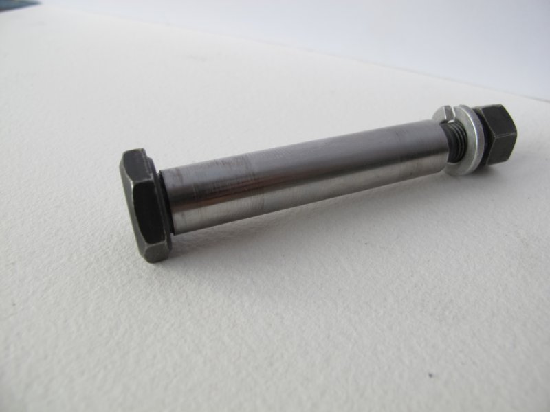

Here are Titanium T-6AL4V fasteners for the door hinges with the guide noses machined in for ease of thread catch.

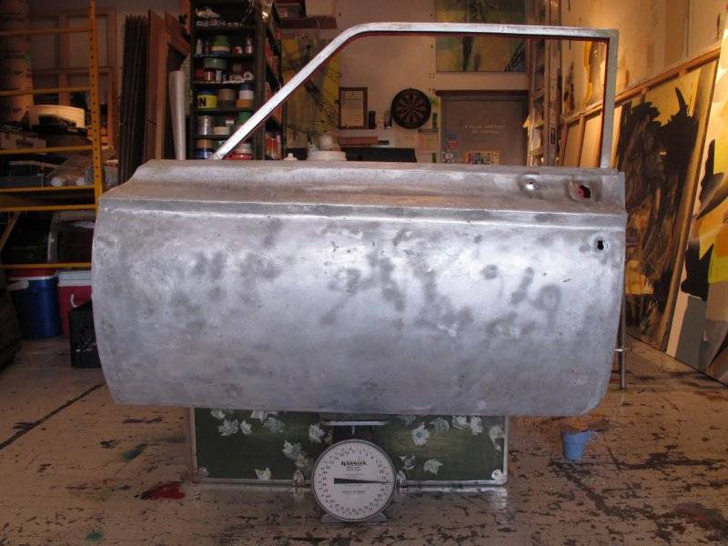

I'm not trying to showboat here, but as far as '64-'65 B cars are concerned, the next best option would be the rare '65 A-990 thin steel gauge doors. Problem is: Try and find a pair.
If you really get luck on your side, the '64 A-865 Race Hemi aluminum doors are the next best lightweight option that comes close in fiberglass weight territory. Problem is: You won't find a pair without them being tethered to an entire aluminum front end.
These are post sedan types and are exact duplicates of their steel counterparts. They were only offered on the Race Hemi package cars and not on the Max Wedge cars which by early '64 were already being phased out in favor of the incoming elephants.
For comparison sake, a factory steel door in naked form is more or less 39-1/2 Lbs. An aluminum door in naked form is exactly 15-1/2 lbs. A true 48 pound difference when you factor in a pair.
Back in '90-'91, I dropped the ball on a pair of NOS aluminum jammies in their Chrysler boxes and never saw another set that were anywhere near decent used-uncut-unmolested condition until 22 years later when these pups came along. As you can see, there were a lot of small pockmark dents on them, probably from curiosity as to their alloy skins. Other than that, they were mint and my friend "The Palm Reader" excellently restored them to their smooth surfaces with little to no body hammering and putty.
This single aluminum door comes in at a poultry 15-1/2 Lbs in naked form, but wait!.............there's more to this than meets the naked eye.

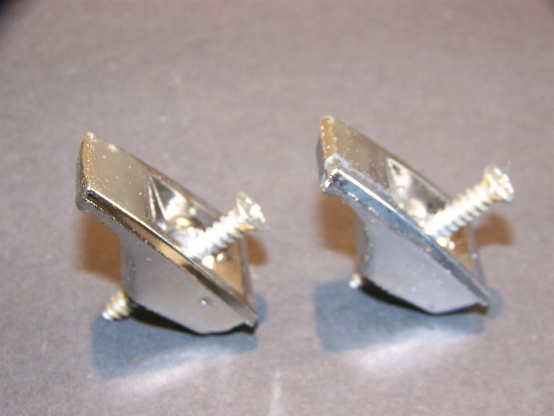

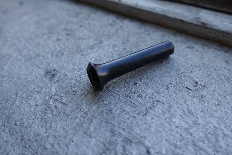

The little lock knobs are usually metal and can weigh a few ounces, but the plastic types are so light, that it doesn't even register on the scale.
When I got replica Super Stock door panels made, I had them leave out the hole for the door locks as I had removed the button and rod. Some people notice that they are missing, but most don't. I just checked my notes and I can't find where I had weighed the button and rod. I will have to find them and weigh they just for kicks.
All these small and seemingly irrelevant parts add up. Don't have the weight figures in front of me, but it was well worth it in the scheme of things.

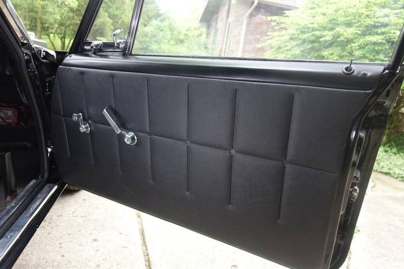

When Legendary was planning to close the door on their limited run of Super Stock interior door panels, I didn't fess up or flinch and probably received the last set made in black. The sales man told me that mine were the last ones in stock and they weren't planning another run.
I know that the A-865's and A-990's had specific interior colors that did not include black, but I wanted black for my specific Black on Black on Black car.
As one can see, the interior material wasn't wrapped up and over the upper door trim panels which are usually covered by the material because I made those out of aluminum. They are wafer thin and weigh almost nothing. The hardest part was making the exit hole for the door knob rods and installing the small trim ring with out leaving an impression.
What you see here is a seemingly stock upper trim panel innocently painted black, but stock it ain't. Again, I don't have the weight figures in front of me, but I will post them as soon as I get a chance.

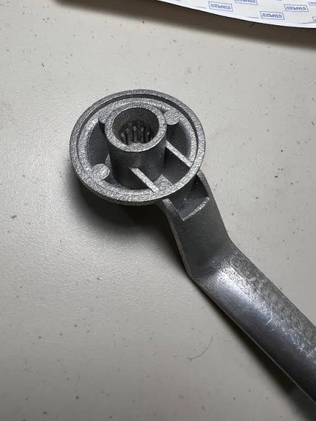

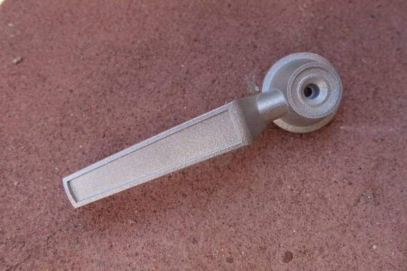

Here's a gem that I've experimented with. Yeah, its crazy and its aluminum, but crazy gets things done.
An original steel door handle weighs 5.35 ounces at just under a 1/2 pound.
This aluminum specimen made through a 3D printer weighs 2.20 ounces. The cad file for the printer coordinates had to be formulated by a gentleman in Detroit that is savvy with this stuff.
After some sanding and buffing cycles to achieve a chrome luster this coming Winter, it should fool any eye as a factory unit.

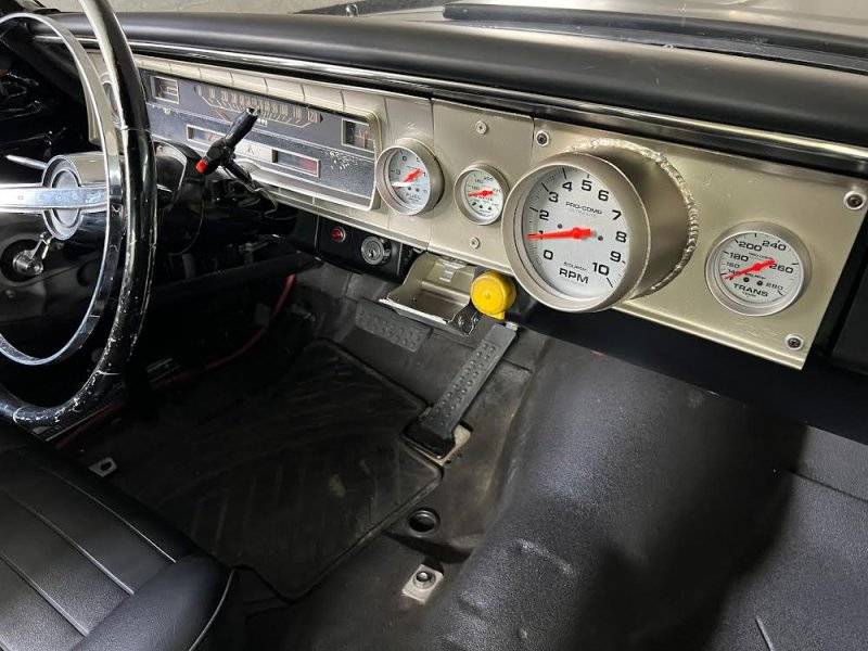

To not divert away from the dash, note that the factory AM radio such as the one that once resided here was a whopping 6-1/2 Lbs alone so it had to go off the air. This wasn't even taking into account the speaker up front just under the dash. For some reason, I never got a chance to weigh the speaker, but muscle memory bets it was somewhere near 4 Lbs.
The dashboard heater controls are gone and so is the heater blower and housing assembly underneath the dash. Who needs heat when header pipes just underneath provide it. It all shaved 30 Lbs.
In place of what would be an obvious radio delete plate is a Autometer Ultra-Lite lightweight series 5" tach installed in its own 20 degree tilted aluminum casing. Excuse the shoddy silicone bead hiding the spot welds underneath.
In place of the heater control panel is the Ultra lite water temp gauge. A plus to this was that the cast metal material directly in back had to be milled/filed off to make way for the gauge, so a few ounces were given the eviction notice.
In place of the heater blower itself is nothing other than open air/desert which lends itself to a good place for an MSD ignition box or other control modules. It also allows for easy access to gauge plumbing and cluster wiring which amounted to a full 1/2 pound of decommissioned wire removed.
My 66 came with factory AC....how many /6 cars had it??! Kinda wish it was still in the car now since it's not going to be an all out race car anymore.

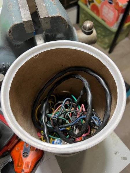

Some of the under dash copper spaghetti I was talking about. You'd be surprised what unnecessary wiring weighs.
Oh man, I know how much wiring weighs!

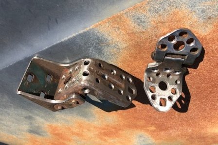

While in the realm of weight loss, but not really something ‘stealth’, I drilled/shaved the lard from the hinges on my 65 Belvedere. I didn’t do too bad in the process. An aluminum hinge set of 4 (with aluminum fasteners) weighs in at 4.6 pounds (estimated with info from Kramer). The stock steel hinges from my car weighted in at 12.4 pounds for the set of 4 (with steel bolts). My lightened set comes in at 5.9 pounds for the set of 4 (with titanium bolts). So, the end result is a 6.5 pound weight savings over the OE hinges, but still comes in at 1.3 pounds heavier than the ultimate aluminum hinge set (but my wallet is $700 heavier in the process).
Like I said, not exactly stealthy, but it works for me.
Did that to my hinges too but more so! Also worked on the stock fasteners. I'm on a shoe string budget.....and hate it but know how to not spend money.
I tried drilling the upper hinge on the body side of my 64. Couldn't find a drill bit that would even touch it. Carbide just made it shiny.
Doug
That's wild.....what does a file do to them? The file 'test' is usually a good indication of hardness.

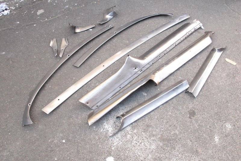

Now that this conversation has found itself deep in the interior, here's a repost of the interior trim panels after chemical milling. The rear quarter window pieces are the heaviest out of the bunch of course.
There are two B-post panels that are not in this picture because they were easily made out of aluminum, but nevertheless were weighed with the whole set.
6-1/2 Lbs in stock form.
After the bath they all weighed 3-3/4 Lbs, so 2-3/4 Lbs were removed.
The two upper door trim panels are also not included in this picture because they were also made of aluminum.
The two panels in stock form weighed 3 Lbs.
The aluminum types weighed 1-1/8 Lbs for the pair. Roughly 1-3/4 Lbs was removed.
In Total 4-1/2 Lbs removed when all is said and done.
