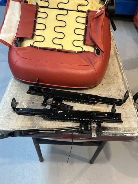

The non adjustable aluminum A-865 and A-990 Super Stock brackets are lightest. You would have to fabricate/invent something to attach them to your existing seats if those are the ones you will be running.Into the interior looking for disposable weight. Right under both seats 6.5 lbs for sliders, each. I haven’t adjusted the passengers seat ever. Bingo. May do both sides while I’m at it.
The shifter base also changed from steel to aluminum yesterday.
Like a treasure hunt.

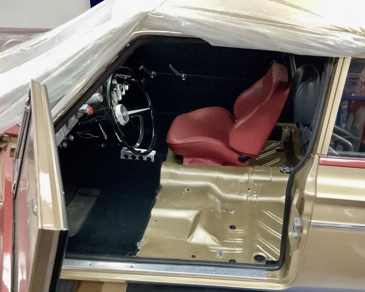

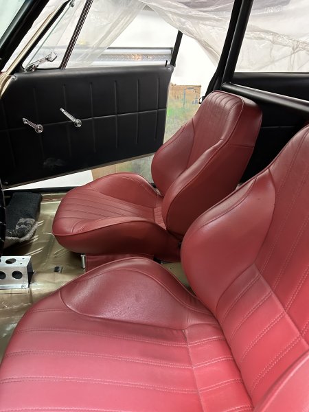

Well the sliders are gone from the passenger’s seat as well as the fabricated metal bracketry that they used to attach to. I won’t be using Super Stock brackets on these seats but rather fab’d spacers.The non adjustable aluminum A-865 and A-990 Super Stock brackets are lightest. You would have to fabricate/invent something to attach them to your existing seats if those are the ones you will be running.
PS: Your Super Stock interior door panels look sweet. I have the same ones in black.

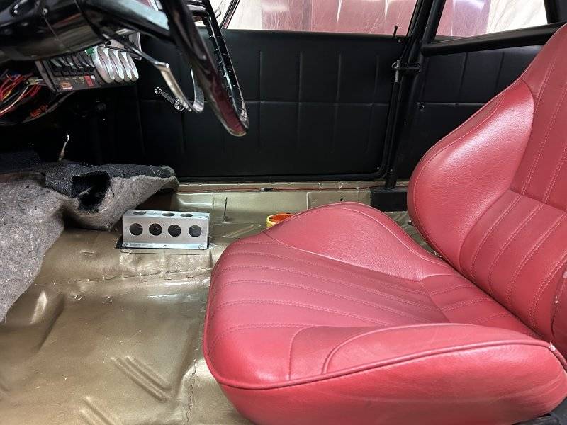

Geeeesh, those seats look really nice aside from seeming very comfortable at any speed.Well the sliders are gone from the passenger’s seat as well as the fabricated metal bracketry that they used to attach to. I won’t be using Super Stock brackets on these seats but rather fab’d spacers.
Solid billet aluminum spacers cut to proper height, drilled and taped on the lathe made this a snap.
They secure solidly to the seat frames and studs on the bottoms of the spacers and through the floor makes the seat a one-minute job to install / remove.
Tomorrow the driver’s seat is going to lose its slider too. Will do a final weigh in tomorrow, expect it to be 24 lbs a side including the aluminum spacers.
Passenger seat in place and mounted. Looks like I’ll be losing 15 lbs with this upgrade. I was sitting on unnecessary weight and never gave it a thought.
Thanks on the door panels. They all turned out nice. The rear seat is covered in the same vinyl as the front buckets (bought the material from ProCar) when I purchased the seats. The top of the rear seat is fading though from sitting in the sun at the track. Gonna have to throw a cover over it or get a tent or awning.

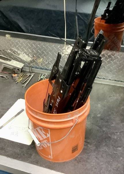

They are comfortable but made for a skinnier arse-type person. I find that the side bolsters are somewhat in the way when climbing in and out but they are staying put. The interior weight pail is adding up. Currently at 17 lbs. I flipped over the rear seat and there’s lots of steel under there.. I’d imagine a guy could squeeze a couple lbs out. ?Geeeesh, those seats look really nice aside from seeming very comfortable at any speed.

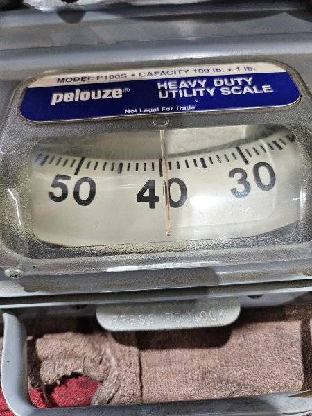

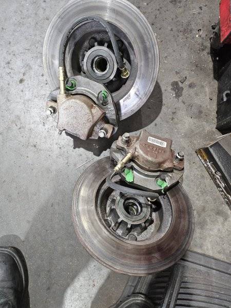

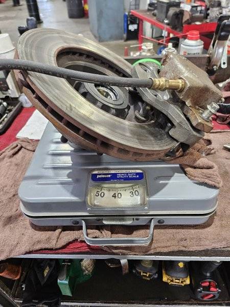

Lots of heavy metal in the factory discs 40 pounds per side. My new brakes are less than half of the old ones. Should help out my short times with less rolling resistance.
Gus

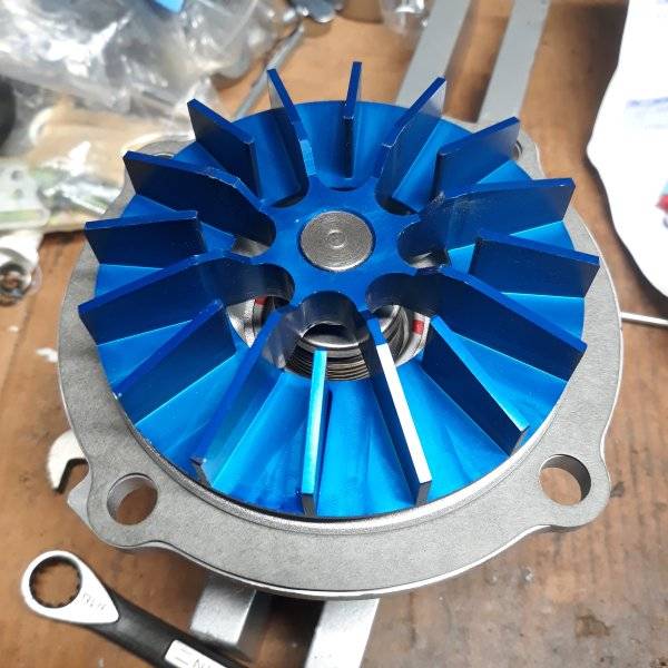

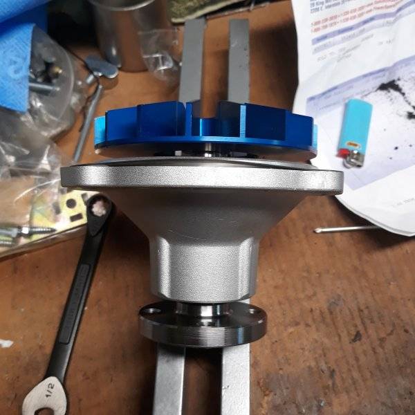

Whoa. That there is some new age water pump impeller. I have a FlowKooler that has worked beautifully for years, but doesn't have as many fins at this one. Who makes it?Super light high flow water pump shed a few pounds.
Gus
Gus.Lots of heavy metal in the factory discs 40 pounds per side. My new brakes are less than half of the old ones. Should help out my short times with less rolling resistance.

Malex.They are comfortable but made for a skinnier arse-type person. I find that the side bolsters are somewhat in the way when climbing in and out but they are staying put. The interior weight pail is adding up. Currently at 17 lbs. I flipped over the rear seat and there’s lots of steel under there.. I’d imagine a guy could squeeze a couple lbs out. ?
Passenger’s seat was back out today for some minor adjustments and what not. Rock solid and lean.
Removed interior weight pail is currently at 17lbs.
