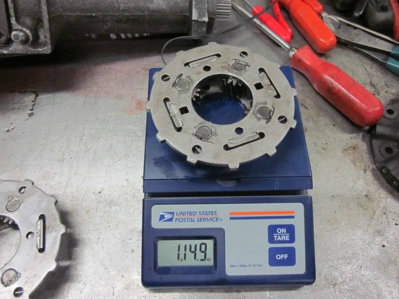

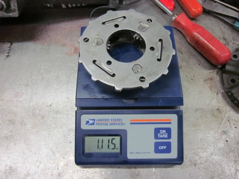

So attached are a couple of transmission weight loss photos.
Once we learned that the 904 would live Keith started changing items one at a time.
In this case we went form a 4 pinion planetary to a 3 pinion planetary.
The results were 1 lb 14.9 oz down to 1 lb 11.5 oz or a loss of 3.4 oz of rotating weight!

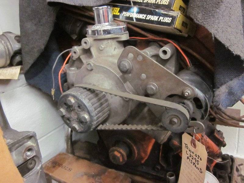

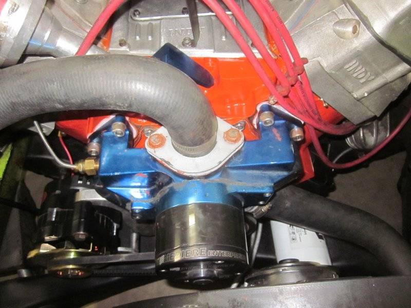

But now I would like to move onto the water pumps and housings.
My first weight loss was going from the cast iron housing and pump to aluminum parts using a Moroso pump motor.
The weight went from 14 pounds down to 7 pounds up front and the engine no longer driving the belt.
The total weight was down to 3034 now and heading toward 3000 lbs!
Later I went from this set up to a Meziere pump with housing.
This later change didn't result in a weight loss but has been a better set-up for cooling.

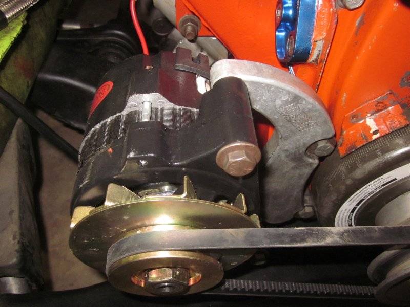

Since you mentioned the alternator that was next up any way.
My first change was from a stock Mopar alternator to a mini alternator.
the weight savings was great from 14lbs down to 5lbs a savings of 9lbs!
But it couldn't keep up with the electric fan on.
So I went from the mini to a 100amp unit that you spotted.
That increased the weight from 5lbs up to 8lbs but still 6lbs less than the Mopar unit.
Nice aluminum low mount with short belt that doesn't jump off the pullies!
The weight was down to 3025 at the first alternator change!
