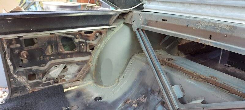

Almost forgot the rear wheel well is in now.
That was a challenge for sure.
The previous owner had done a hack job removing it so it was quite the job replacing it.

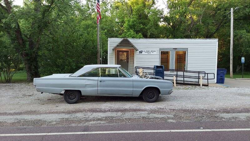

Ok so it's been out for the first shakedown runs. So far no real issues. A few rattles that need to be tracked down and brakes need some attention as they seem to be just a suggestion.
Looking at this picture can you tell me, is my rear too high or is my front is too low?
It had air shocks with extenders, I removed those and put on regular shocks but it still has a stink bug stance.
Do these air shocks make my *** look big?
Lol, congrats man. Enjoy driving it.
You could level it out a bit by cranking the torsion bars up in the front.
