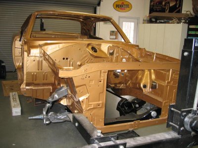

Began reassembly by powdercoating all of the undercarriage parts and suspension parts the correct color. coated axel tube, third member, K frame, Control arms, spindels ,Stabilizer bar strut rods , Torsion bars, Etc . Just trying to bullet proof underside of car.

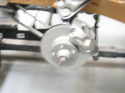

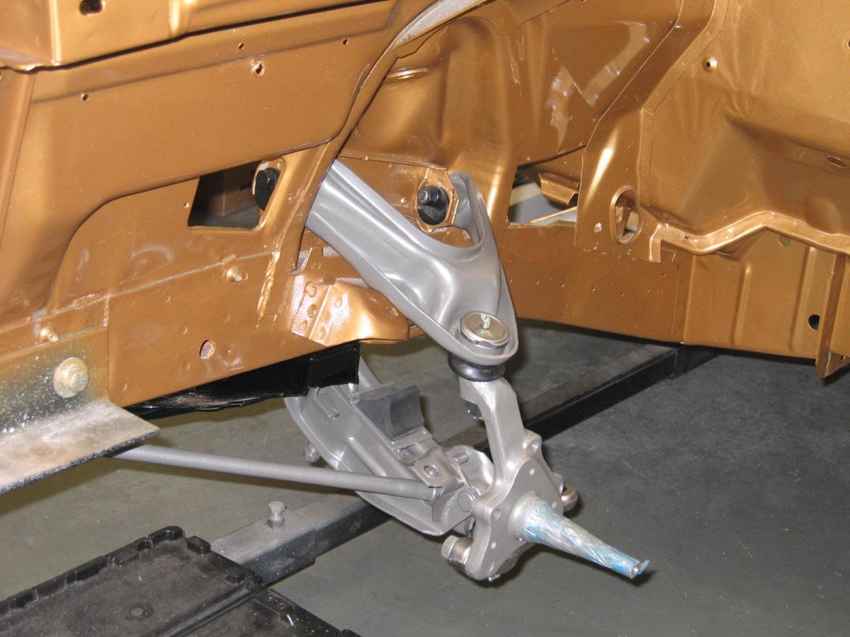

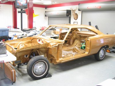

After I assembled the front and rear brakes, By the way 4 piston bendix power disc on the front. Also I sent the calipers out for stainless sleeves. Then powdercoated rear drums and front rotors and calipers.Almost forgot I diassemled the rear leaf springs after I had them rearched, and powder coated them ,in the correct color. Finally I can get the car back on the ground. The rollers that its on are from a 68 Satty parts car. Installed steering gear, Wiper motor , Then start on heater box and dashboard.

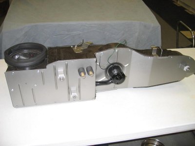

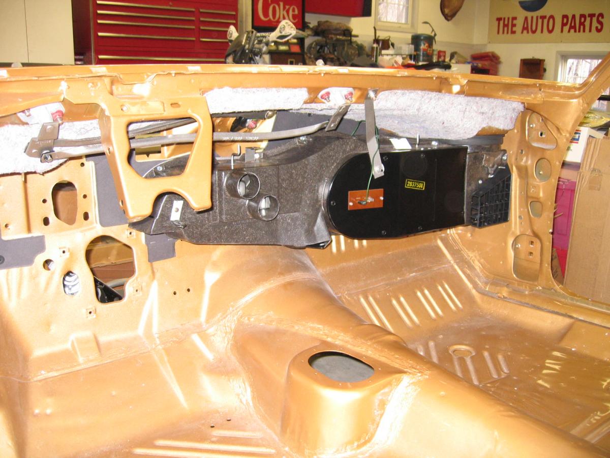

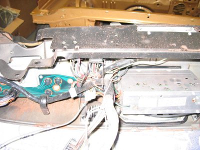

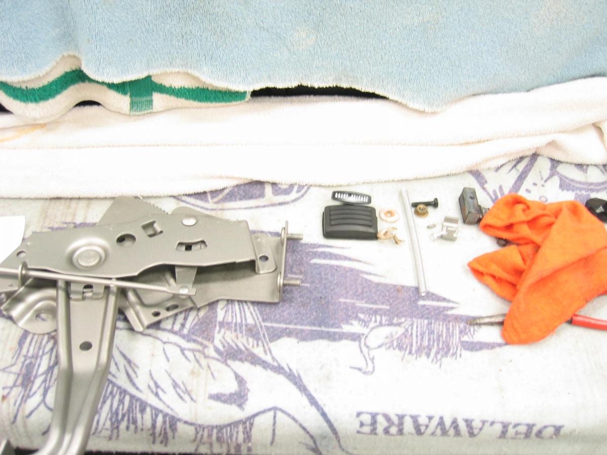

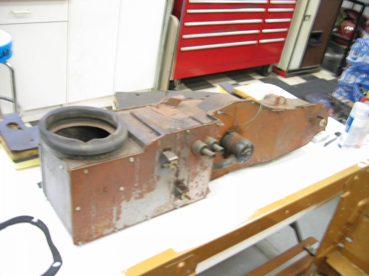

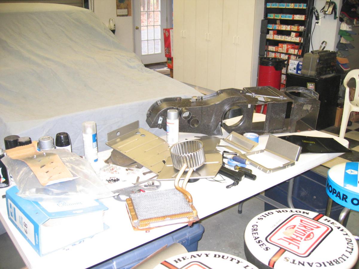

I dissasembled the entire dash and stripped the metal frame for new black paint. Checked all the switches and guages, Updated the dash tach / electronic board. Reassembled the dash . I could hardly believe, that all of the guages and switches and speedo worked and are the originals. Some more pics of htr box installed dash . pedals , etc.
