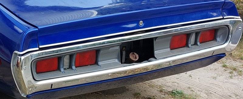

Here's a for instance. of what I'm seeing.
I've painted many chrome bumpers,,,da sand them with 80 grit, Etch prime, then regular prime or use a direct to metal primer and then paint as usual...tough as nails.....Good luck

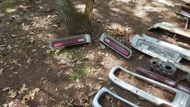

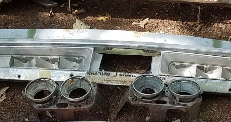

AMD, original was NASTY!!
From parts car too.

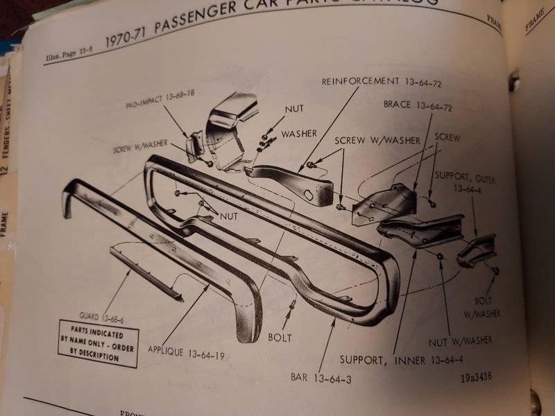

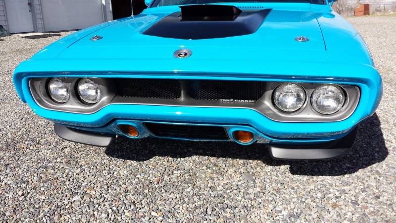

What is the story with the surround on the front bumper? I've never seen that before.
To the original poster - I used 80 grit on my drill and sanded the crap out of my chrome bumper, then primed. I don't know how long it will last, but I consider it temporary. Real painted bumpers have an elastomeric coating (or so I'm told). I prefer the painted bumpers myself (I'm also a 3rd gen owner).
It's call an Applique or brow that is on the 71 Plymouth color keyed bumper.
Also a note. The B-body color keyed bumpers are not done the same as the E-body ones.
E body the bolts are welded to the bumper and the heads are ground smooth. B-body the bolt heads are painted.
E-body has a think rubber like coating as where B-body has a thick flexible paint.
Also wanted to add that I used an etching primer first.
Does the applique have a function?
I can't believe I've gone this long without seeing one.
Just for looks I guess and also something to spend a lot of money on.
