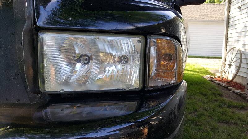

I do the wet sanding with 3000 and duplicate color spray can clear. Works great and lasts for a long time. These were orange they were so clouded up.
