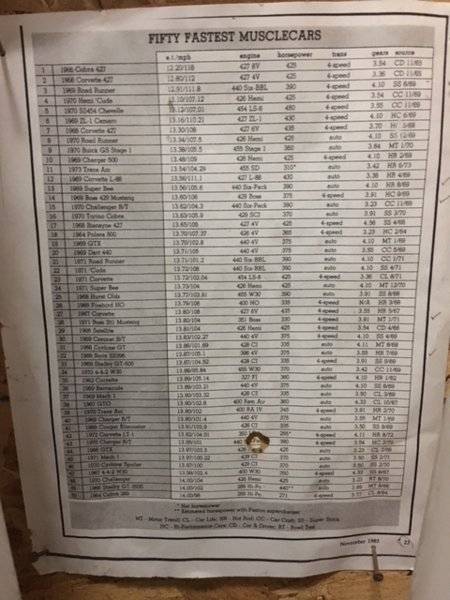

I keep a copy of the list on the wall of my garage. I'm a fan and owner of the 69 440 6bbl Road Runner. Love that it's third...hate that the Cobra and Vette were included.
I have that same chart some place around here.

I keep a copy of the list on the wall of my garage. I'm a fan and owner of the 69 440 6bbl Road Runner. Love that it's third...hate that the Cobra and Vette were included. View attachment 556114
Your in box is full. Could I get a copy of the chart please? Where in Pa are you? I'm just north of York.

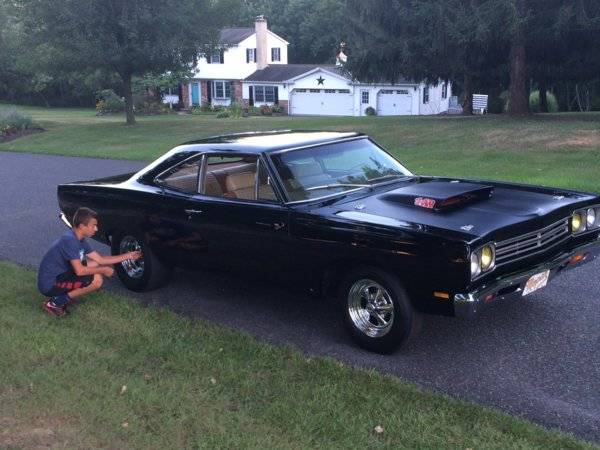

I am in Harleysville, PA. Just north of Philadelphia. My RR is an original 383 car. It shows me as the original owner, but my grandfather purchased it from Lansdale Chrysler Plymouth. I checked my inbox, and it is empty. I'll send a note to your inbox with my email address. Feel free to reach out to me. I cloned my RR to an A12. It has a 496 with a small solid roller cam. it went 11.07 @ 123 last year in street trim. Hoping for a 10.99 this spring!

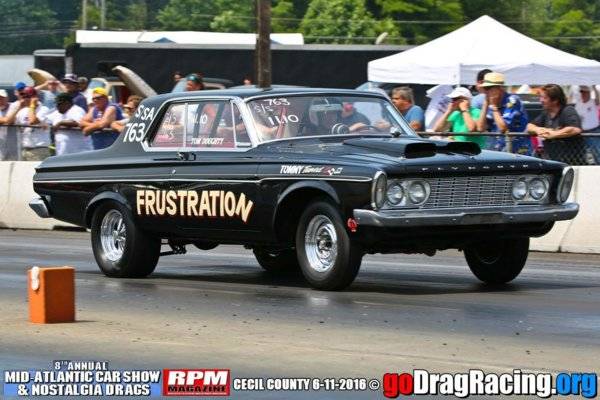

Cecil, Atco, E-Town, Island, Beaver Springs, and Maple Grove...in that order LOL. MG is still tough on racers, but they're not as bad as they used to be. Typically I race "FRUSTRATION". The RR is my street car. Ironically it's as fast as the race car!
I'll look you up a beaver this year.
I don't race anymore.................. afraid to brake something.
