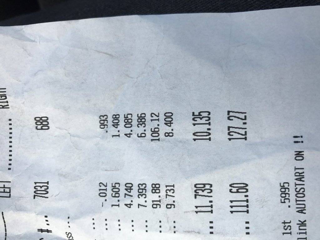

Mike we out yesterday again flat performance. I only made a single pass using launch with foot brake. I developed an oild leak on my caaumlator fitting so that was it for me for the day. I think it needs more timing. its set at 30 but seems flat. Whats yours set at? my 440 seemed to have more pep.Chris....keep us posted...thanks for ur 1st outing report
It is a process.I always hate the sorting-out period. Glad it's making noise and covering ground.......
Thanks Mike your not far from that yourself. I know it will go much deeper but, the question is do I want to. I race alone so it's not all that easy at the track to literally bolt yourself in the car.You have a 9 second car and have now joined a pretty EXCLUSIVE segment of B-Body Racers.
Congrats.
Oh so true. I think 10.0 or near there is just fine. it's just less work. I do this for fun. Never made a dime like most hobbies but, it certainly makes me grin. It was good to be back at the track yesterday.Yup, same situation. The faster you go, and older you get....the tougher it is.

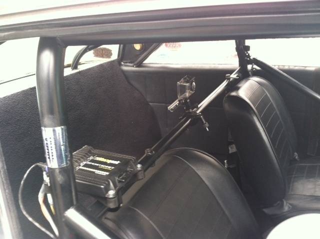

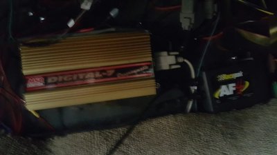

I totally agree. My buddy has a fast data logger. We used it on my 440 to dial the jets in. I currently have a plx unit but it does not log
Very good info thanksWhere you need it most is at the 7 second mark to the stripe to get optimal O2 readings at WOT! I went from a 8.84 off the trailer to 8.57 by the end of the day changing A/F and jets

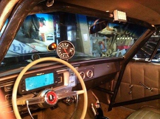

hard to say exactly and also hard to say how accurate that chip is as well. I am moving it up to 7200 and shift at 6700 I will know more then. A lot of guys don't even use the rev limiter chip because of that reason.Maybe its my eyes but it doesn't look like the tach ever even hit 6800,maybe 6500
