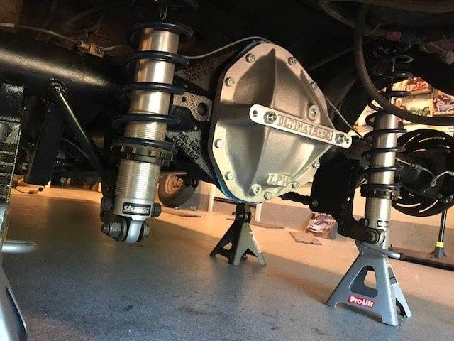

The latest bad news. I took apart my Dana 60 for a gear change to 4.10 and found a couple of problems. The pinion races were not tight and I noticed they had spun some. Not bad but never good. From my training on Navy radar gear boxes a loose fit is not a fit. We always had to dry ice our races to get them to fit. So out comes the housing and off to the shop for repairs. Another week of so for repairs but, I think it's the best thing to do. so far front to rear is all redone after this. I hope it stops there. I want to go racing.

We'll currently I am having a gear change from 4.56 to 4.10 and discovered the pinion bearing races not tight so that is being repaired and I should have it back Friday

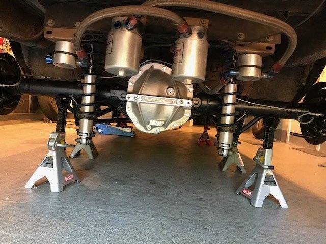

Well I finished it up today. Run tomorrow night. See what happens. some pics.
