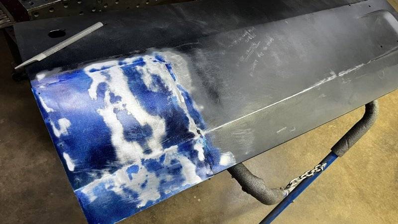

Bit of a catch up. I thought this door rust repair project would take a weekend plus a weeknight or three.
It took a month.
The car must have set under a carport. The driver side is in excellent shape while this passenger side must have taken on some rain from being at the edge of coverage. The PO scabbed in some junk so the filler would take. This low crown panel with a key body line turned out to be a real challenge. High crown panels are easy by comparison.
I had to make this particular patch three times before I got it right. Low crown is hard, but I'm a little better at it now.
With limited access to the backside of the panel, planishing was a challenge. I spent an entire day with a slap hammer and shinking disc to get this smooth within .035". I only know it's that tight because I couldn't fit my TIG filler under the lower points.

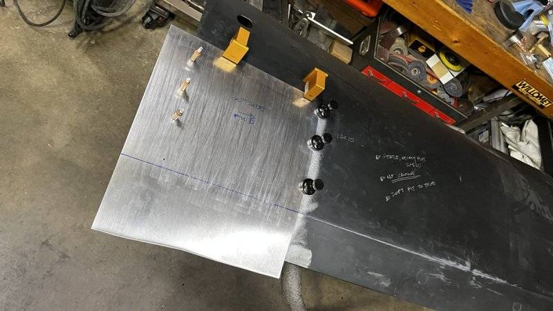

I got these AMD tubs about 95% done before I was burned out on them. Picking them back up, I used the planishing hammer to fine finish the reworked front radius and flanged the rear similar to the inner edges.
Silicon bronze is my go to for making a weld look like it's bent sheetmetal.

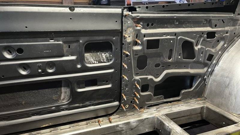

New passenger door jam.
Everything in the unibody that can get a dimple and get stronger and a bit lighter, will.

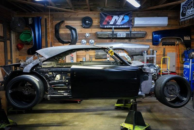

Now, to make a big leap in assembly.
The go-kart is about to get a lot bigger.

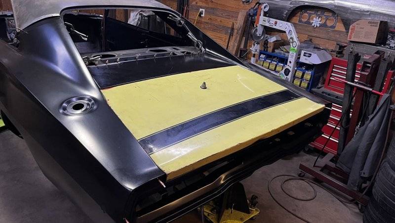

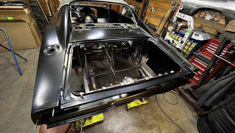

A childhood of assembling general lee models has paid off, and my welding project has finally turned into a charger.
OE truck fit check, and everything is gapped pretty well with just minor fitting of the rear deck filler panel.
Front fenders ended up hanging pretty easily once the doors were fit, and I built a quick structure to make adjustments a bit easier. We put the tram gauge on the car and verified key dimensions side to side are identical. That was actually a huge relief.

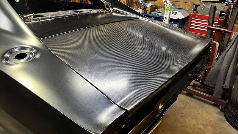

And something I've been excited about for months now...
That was my super bowl.
A few details. I picked 68 fenders and quarters because the marker light holes are smaller and easier to fill. The fenders will be modified to have a 1970 forward edge that matches the bumper, and I'll reference the pair of '70 fenders I have as a template. The front suspension is set about 2" forward from OE, so the arches will get moved and modified to fit the 305s at full lock.
The Speedkore hood is 21.5lbs where the factory one weighs 70 (that figure includes a bunch of pecan shells a mouse stored in there at some point). The trunk lid is 13.2lbs versus 34.5. All together, it's about a 70lb reduction that would have otherwise set high in the car.

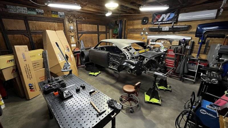

I still have a ton of work to get the body locked down, but the first orders of business are reorganizing my shop to accommodate this seventeen footer. It was pretty easy to work on it when it was just a go kart, but that day has passed. And, getting a green laser because my red one is almost impossible to use with the lights on, and the long body line won't forgive a half-baked effort.
It'll be good to take a break from all the body setup, so steering column and headers are probably next.

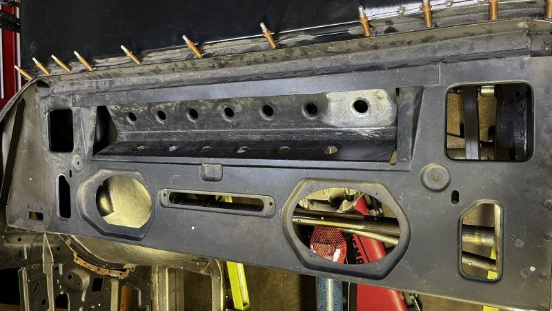

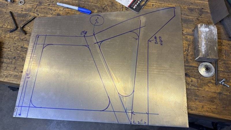

Working on improving the internal cowl drainage and gaining some interior room for air conditioning and ECUs and maybe eventually, people.
It’ll drain at the side similar to original.
David
Took a bit, but I found a way this panel would flow. Tricky shapes, but fun to make.
Each of these plates will gain a useful amount of interior space.
David
Finished the cowl and added some detail to the firewall.
The other side will have a similar profile with accommodations for steering shaft and hydraulic reservoirs.
