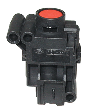

I have an electric fuel pump on both cars and installed an impact relay ( inertia switch) ahead of the control relay. I can tap it and trip it, the fuel pump won't run. Its just a manual reset on it and takes two seconds to reset.
You could also do this on a start relay if you have a mechanical pump.
I also have a main switch mounted on my battery box in the trunk if I'm really paranoid.
