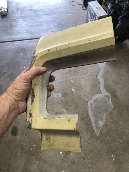

They don’t aftermarket these rear body endcaps do they?
Moparfiend
5:28 PM
Oct 27, 2017
3,304
3,696
HOT
They don’t make these rear quarter end caps has aftermarket parts do they? For my 1970 Sport Sat same as the gtx or RR. Its pot metal and my driver side is damaged and pot metal is horrible if not impossible to work with (maybe this thread will turn into a repair of pot metal) as I can’t find anything online.
Thanks MF
You may be able to lead it. Rough up the dents and use lead to fill them. Lead is easy to sand but I'm not totally sure that is the way to go. Maybe that muggy weld stuff. The headlight trim in the second video came out fantastic.
Thanks thats what I figured since it was originally pot metal. Funny listing the guy claims like new but has a broken stud and a dent. Mine has all the studs and two dents I guess mine is like new as well lol.
If your studs are intact, that is the main thing imo. Can't you just use some Fiberstrand filler to smooth over the dents?
