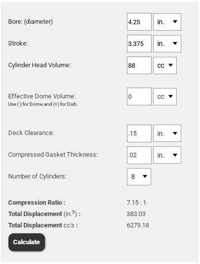

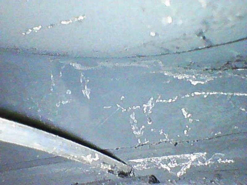

Got a cam lobe go flat, and was pondering what to do next. Before jumping in with a solid roller, I decided to boroscope the cylinders. Looks like the motor was probably rebuilt. Has stock .020" head gaskets, but the pistons are completely flat except for the forward notch. No valve reliefs, and it's easily over .120" down the bore. Using a .060" wire as a gauge, the piston to head gasket clearance is 2.5-3 times it's thickness. Just .150" deck height, .020" head gasket, and 88cc for 906 combustion chamber, I get 7.14:1 compression ratio. Here's looking from the spark plug towards the intake manifold. You can clearly see the head gasket, the silver line, piston bottom.

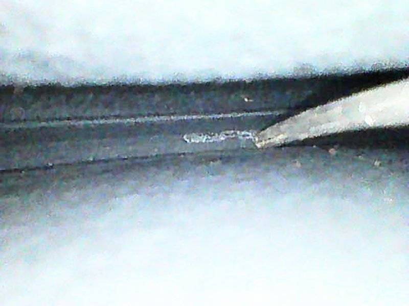

This is looking forward, you can see the piston forward notch, but can't really tell where the top of the deck is, or what is the combustion chamber. Still, you can tell there's a ton of room. The curved line on top is the exhaust valve.
