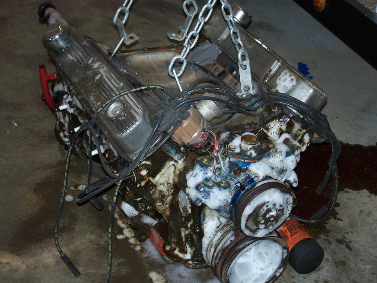

Cleaning my 400 before i paint.

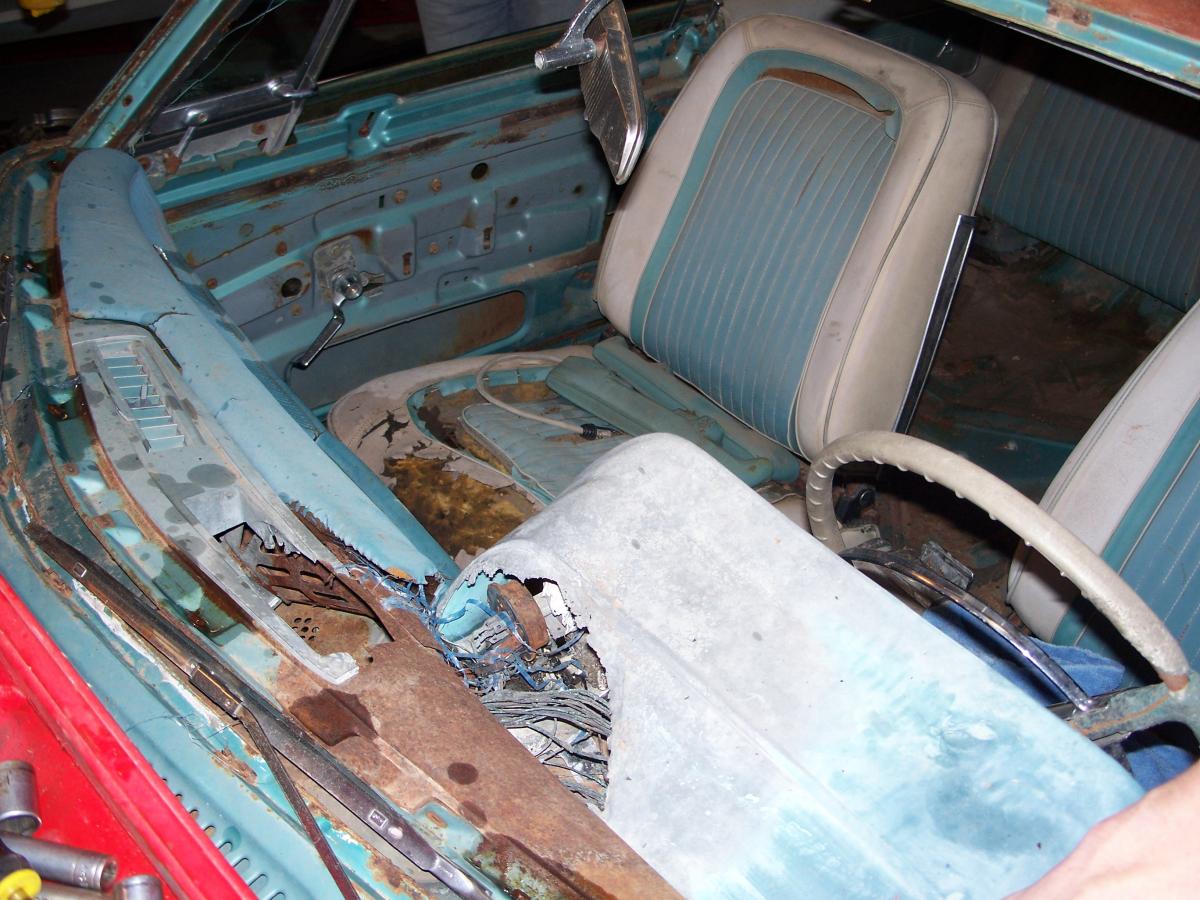

Here is the dash fire, and yes it took the front glass out, was a relay that shorted out.
