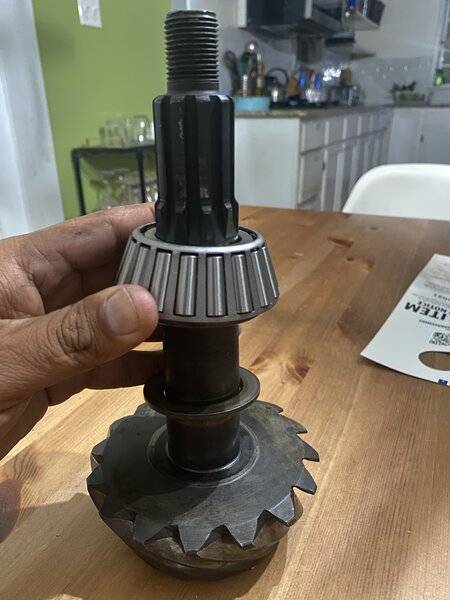

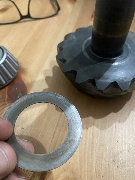

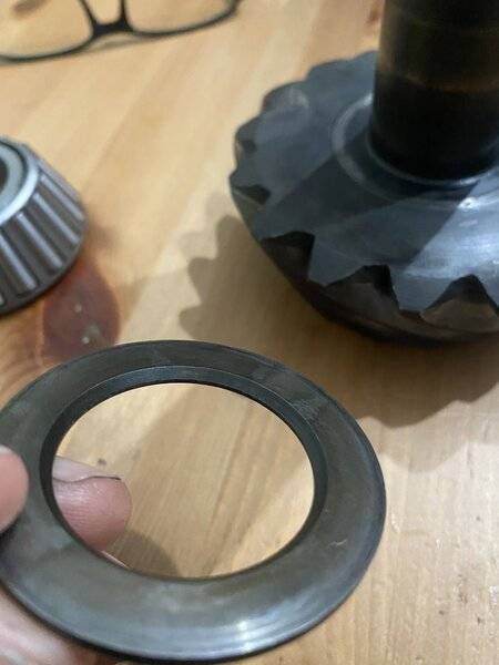

Thank you for the feedback. One more question. I was about to press the rear bearing on the pinion and noticed there is a washer/shim between the bearing and pinion gear. I did not pay close attention when I removed it and did not notice one side has a taper while the other is flat, as shown in the pictures. Do anyone know what side the taper goes against, the pinion or bearing?
