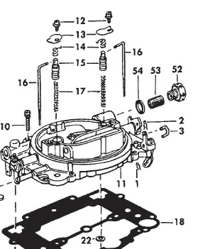

Bogging with the AVS2 could bee a few things - Float level - Air door spring adjustment to loose
Accelerator pump adjustment

Carb: check float level [ 7/16" ]. Wind up spring on the air valve a further 1/2 turn. Sec jets may need to be bigger. Do not go up one size. Go about 3 sizes to get you pointed in the right direction.
