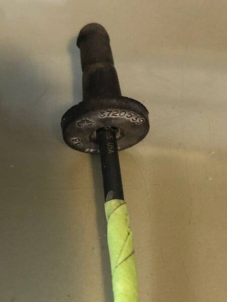

Anybody have a good way to install those flippin' things? I always struggle with them, but eventually they go. Not on my current RR though. Hammer, punch and hammer, silicone spray. No, no, and no. Managed to break 2 already. Fresh paint on the car, so I am not going to drill out the holes. Think by cutting a slot into the shaft that goes through the metal would work and still hold?

I warmed them up a little bit with a hair dryer, then put a little bit of grease on them and used a small Phillips screwdriver that fit inside to push them through the firewall.

To answer the ops question
I drop them on a pan of hot water to warm them up. then push in with my hand , worked every time
Ended up getting them in by putting a bit of grease on the tip and tapping them with a hammer just to the first ridge. They wouldn't go any farther no matter what I did. Ended up breaking 2 of them by trying to force them. Then I went on the other side and pulled them through the rest of the way with a pair of pliers. Actually went pretty smooth.
