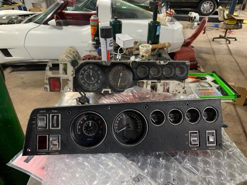

Lots of opinions regarding original vs repo. I use original and when restored correctly they are very functional and over-the-top beautiful! Quartz clock upgrade which is accurate and uses very little power (compared to the contact/reset of the original). The tachometer sonic cleaned, jewels polished on sweep mode for 3 solid days, pointer balanced and solid state board is installed (which works with original points and electronic ignition). Tach is calibrated using the same technology as solid state tach board. All original coating removed from face plates, painted, and premium overlays installed which are very accurate, bright white letters/numbers and UV protected. Original is better:)

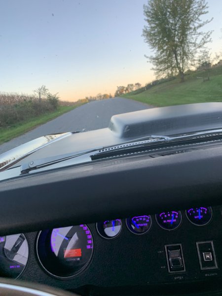

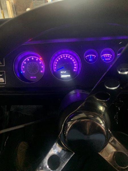

I went with the Dakota Digital replacement (The RTX Rallye setup) and have been beyond impressed. Full discloser took a minuet to get and they certainly don't give them away but it has performed flawlessly and added form and function to my car. Remember As stated options are out there!
