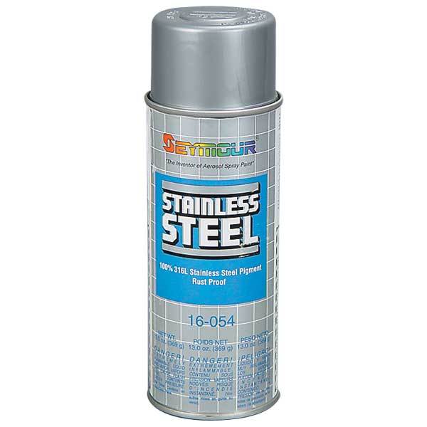

As far as the bare steel parts go, My book by William Hurd/ Roadrunner restorations say that a product called Stainless Steel Paint with real Stainless powder for pigment works great! You have to root around for it though. It's about $7.00/can. $T2eC16RHJHMFH!!f8J7yBRwHmqg7og~~60_3.jpg
