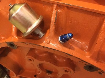

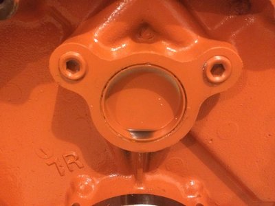

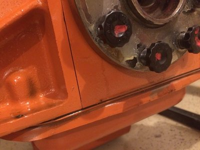

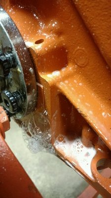

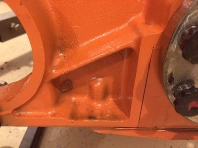

So today I started my freshly rebuilt 440 and worked out the normal teething problem leaks. However, I noticed a nice oil pool on the ground at the back of the motor and can't believe this!! I'm grasping at straws here, but might a RMS leak with break in oil versus normal oil? :wtf:
Oil shouldn't make a difference. A leak is a leak.

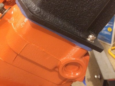

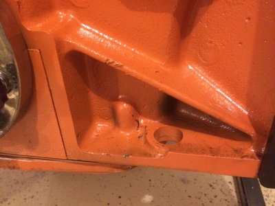

Make sure it isn't coming from above. Rear of the valve cover. Oil pressure sending unit. If you have your inspection cover off, look at the flywheel flange on the crank and see if it's wet there.
Yea, that's what I figured. The oil sending units are dry. Will check the valve cover and see what I can do about seeing the converter flange/crank area for oil.
And then you have the two oil plugs by the rear cam plug&cam plug itself. Sorry about that!
