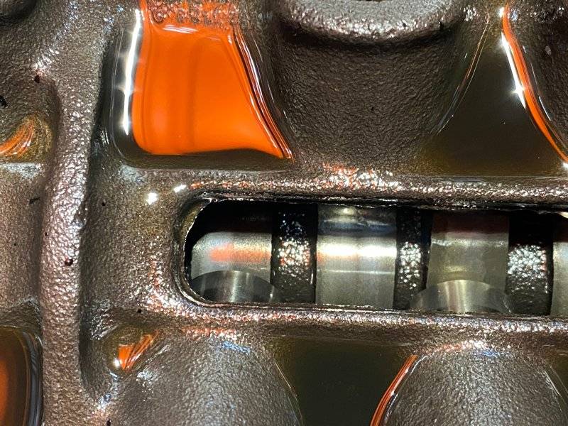

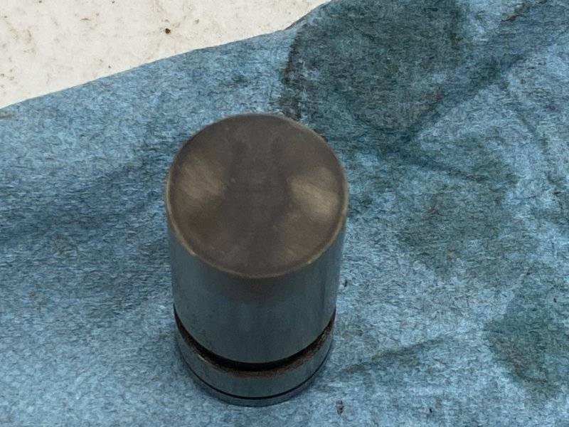

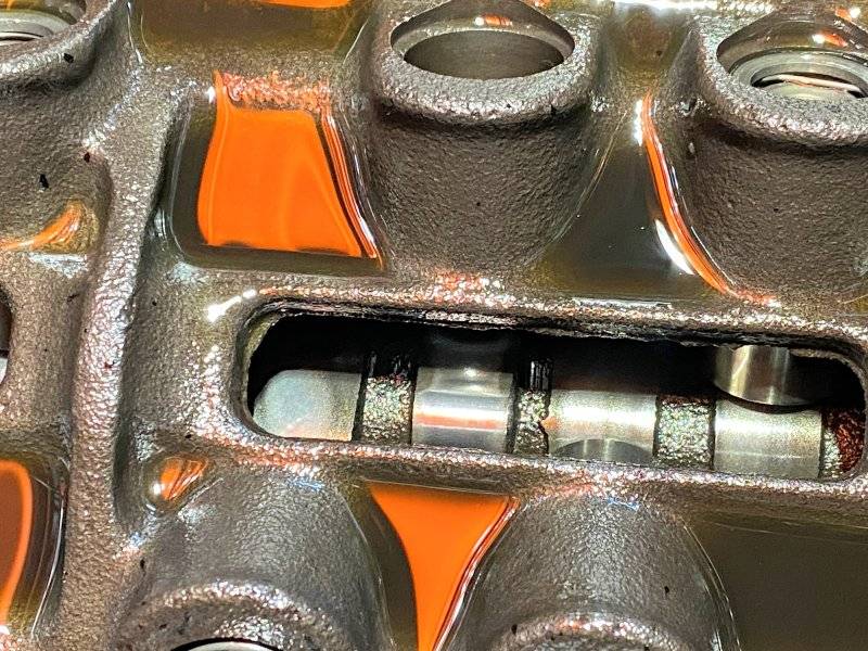

Since the body shop can't fit my car in till June 5th I decided to address the annoying tick I have. 500 miles, Vodoo 702 cam all the other lifters and lobes look great but this one has me questioning if its rotating properly. The back of the lobe has wear unlike the others like the one on the left. The lifter has a single line pattern and a slight line in the center. Hard to get a good pic of that.
Back side of the lobe. One on the right, I would expect it should look like the one on the left.
Top of the lobe.

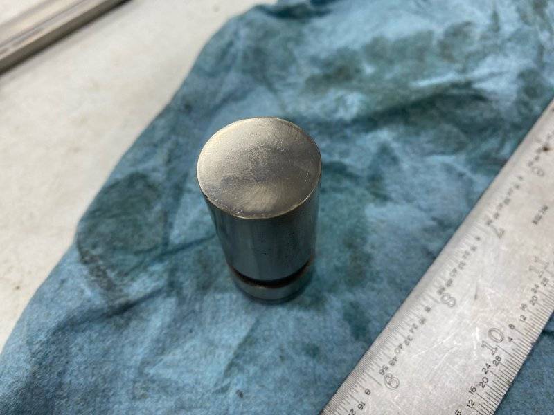

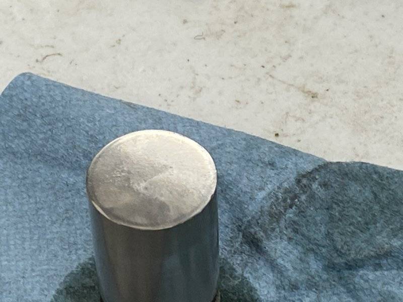

Lifter

Not looking good. Put that handy straight edge on the bottom of the lifter
It’s “done”.
Imo, none of the lifters you’ve shown look “good”.
One is toast, one is well on its way to being toast, and the one that hasn’t really gone past the point of no return, still doesn’t look like it would live a long happy life.
Edit...... are the 2nd and 3rd lifter pics the same lifter?
Looking at those pics closer...... the single wear line is on both.
When you see that, it’s the beginning of the end.
Edit 2- I’m now thinking that’s 3 pics of the same lifter?
You’re correct about the wear pattern on the cam.
You’re not going to get proper lifter rotation when the lifter is contacting both sides of the lobe.
I put the calipers on it and the crown is pretty much gone in the direction of the wear verses opposite of it. Caught in time to save the engine? I sent the oil out for analysis but done have the results yet.
This one appears to be at the very early stages of the line forming.......
Plus there’s a small chip out of the corner of it.
