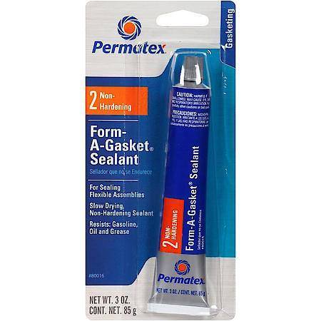

Going back 40 years I used Permatex non hardening... think I still have the same tube in the tool box...

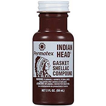

I find it gets brittle, maybe from the "shellac". It's ok for gaskets that are not subjected to extreme heat. Useing it on valve cover gaskets, you'll see after time, on the lower half of the gasket the sealant will be brittle from the heat compared to the upper half. Not saying it wouldn't work, I just like the Permatex #2 for the flexable properties.
