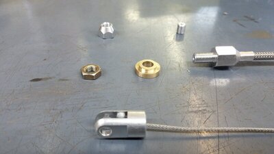

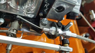

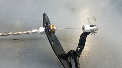

The 6 cylinder cable is the longest. It’ll reach a crossram. The E Bay $25 braided cable works nice. But they require a little mod at the pedal attachment. And a custom carb bracket.
