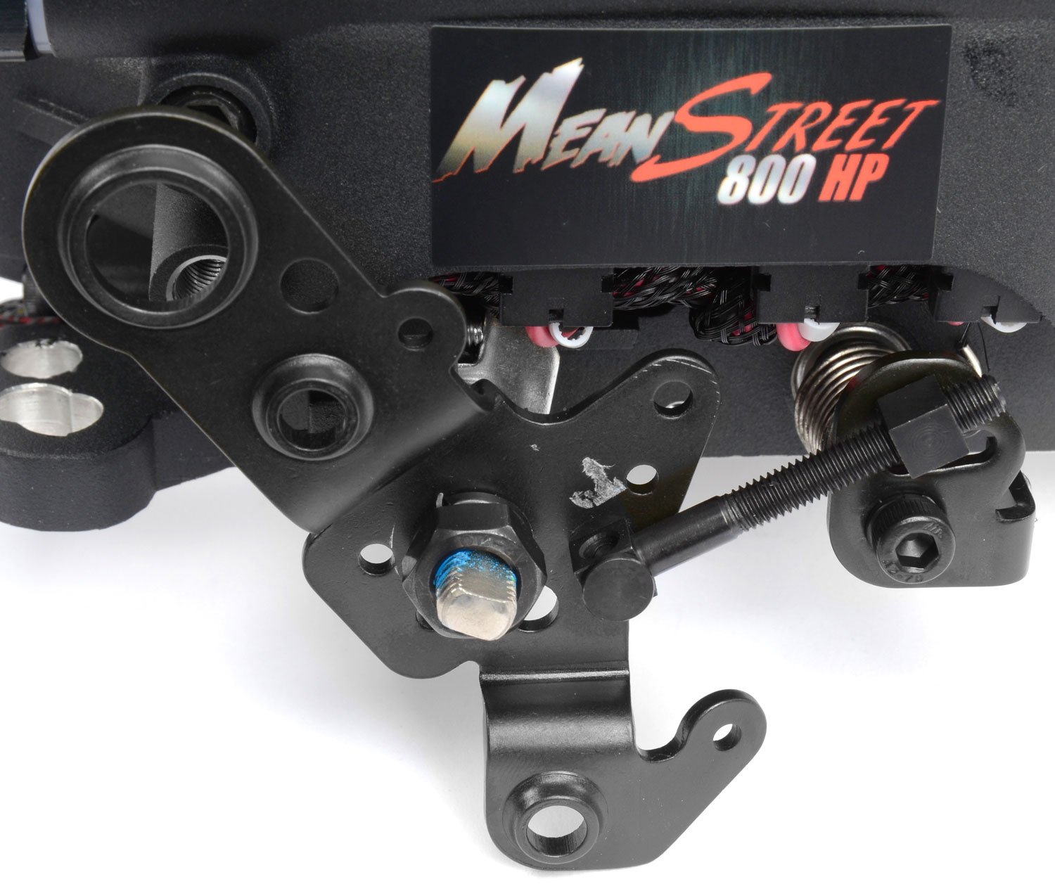

Throttle arm on the EFI unit looks like this:
https://images-na.ssl-images-amazon.com/images/I/71oG4BAz5eL._SL1500_.jpg
No room to come through from the inside.
Are there wire ends that you could screw onto the EFI arm that would accept my cable? Or do people fabricate something on their own? Or should you replace the entire wire? Help!!!!

If all else fails, loosen the nut that holds the throttle arm to the shaft and pull the arm away from the body far enough to insert your bolt from the back and then re-tighten it. I've done it and it's not hard... I would recommend getting a bushing from Summit or Jegs and using the top hole. The spring pressure of the FiTech throttle body is pretty hefty and the farther from the shaft you connect, the better the ratio is.

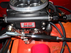

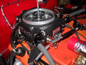

I'm thinking you will be using the hole half way up the side of the linkage? it is similar to the generic linkage arm on most aftermarket carbs and EFI now days.I think if the arm was rotated a bit you'd be able to install the pin you want. there are some extremely short cable pins for the Mopars. I have one that is very short that the outside has only a ball for linkage arnm that could be removed. if you think you'd like to try it- its a freebie. Geri
View attachment 558189 View attachment 558190
nice setup you have there, good work.Geri
