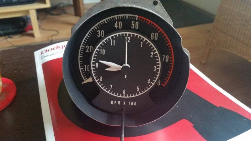

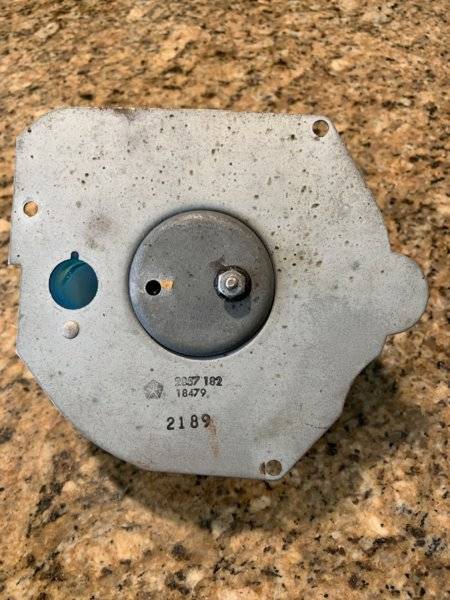

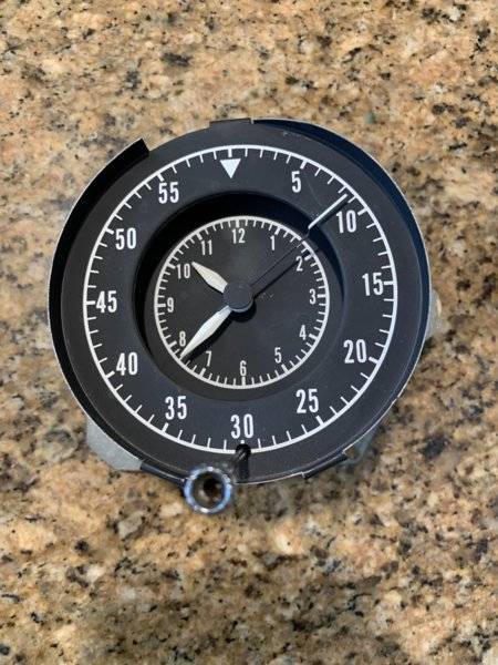

These are photos of the tick tock tack out of my 70 Dodge charger, not quite sure how to hook it up. I think I might be missing a terminal off the back of it. Anybody got pics of theirs or advice
Roger that. I’m new at this Restoration thing. For some reason I was thinking the 0 to 60 on the outside was attack but now that you say that it’s obvious it’s the second hand. Thanks
Sorry 70 plum.. I just "had too". I actually have to add that it happened three times last night, someone calling one of these a tic toc tach vs a regular clock. "Tic Toc Tach" refers to a Tach with a clock in the middle of it. If it's just a clock.. well it's just a clock. Power on the terminal and the case gets it's ground screwed to the instrument cluster frame. Test it before you install it, many have burnt points and they don't run.
70 plum charge,
If your clock won't work touch base with me. I have a step by step guide on how to fix these. I can't find it right now but if you need it I will take the time to dig it up. It also shows you how to speed up or slow down the clock.
70 plum charge,
Or if that doesn't work, get the clock mechanism replaced with a Quartz Movement. I had mine done years ago, and it never failed after that. Keep all the same fascia and hands etc.
Is there a way to bench test these in the car? My clock works, the tach doesn't. Has an MSD 6A system including the adapter which is likely to blame for the tach not working, at least I hope so. I would like to run a couple wires to the appropriate original points and just see if it actually works before tackling the wiring maze.
