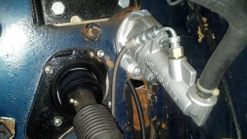

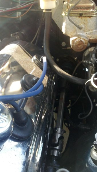

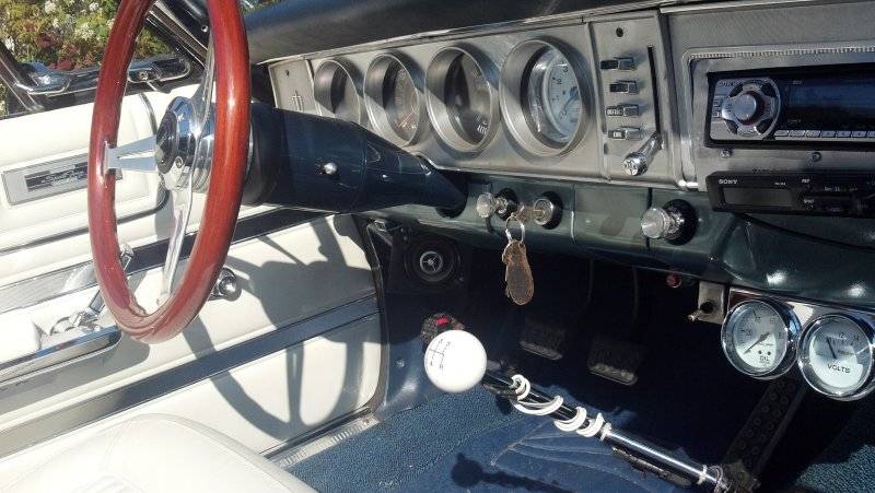

I have a Flaming River tilt column with a Grant steering wheel in my 64'

since 2008. My set up does not use any of the factory components except the power steering box.

Perhaps the tech assumed you wanted an column that was listed for your Savoy. The part # is FR20006CP. I looked up the part number on their website and they now list FR20006. A 32" floor shift, paintable, tilt column with GM wiring. When I got around to the wiring I had to cut the factory connector and a Flaming River tech sent me a wiring diagram for the different wire colors to splice using a copy of a Plymouth factory wiring diagram. My steering shaft is the double "D" style. I had to cut-to-fit the shaft. The column floor mount part number is FR20114. They were very helpful at the time of my purchase and install. On a previous build, I used an ididit column in my 49 Dodge B1B panel truck with Fatman's Fabrication Mustang II rack and pinion set up. Both companies provided quality products and customer service.
