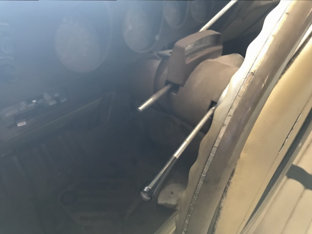

the only one in a 71 i have ever saw was in a
71 charger se 383 auto column tilt w cruise control.
so they are out there,but extremely rare/hard to find.

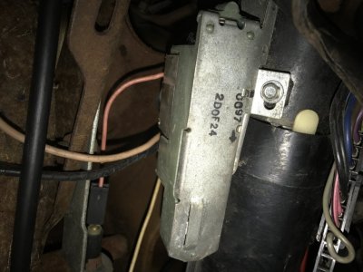

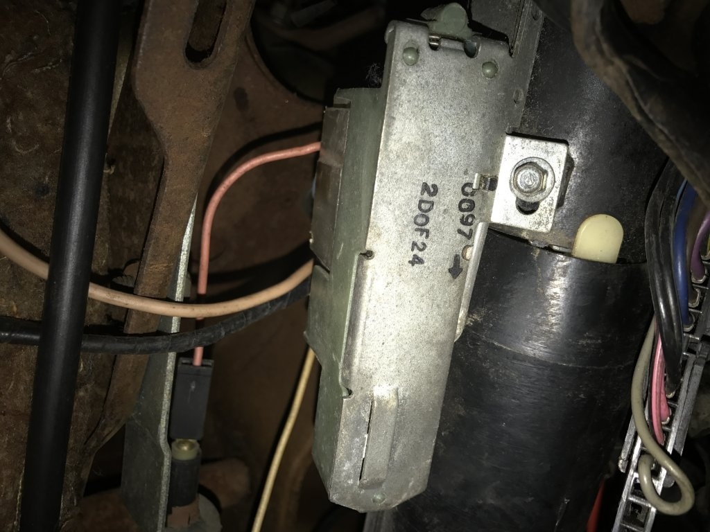

It is a GM column supplied to Chrysler. It has a wire harness pigtail to go from GM ignition switch to mopar at dash harness.
