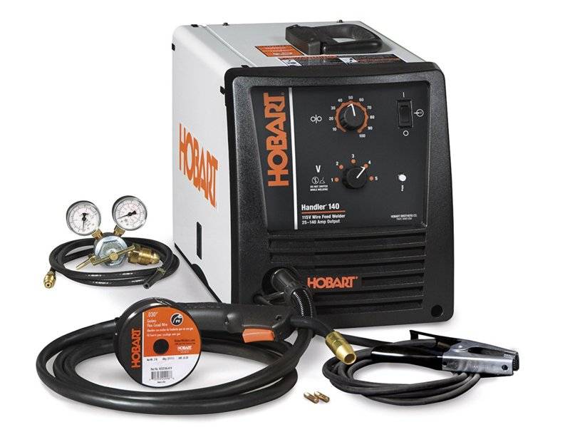

Check out this Hobart wacko. It's a great beginners MIG.
https://www.amazon.com/dp/B009X43F38/?tag=crweld-20
Good advice on this one. :thumbsup:
I just recently bought one and love it. For the price and my level of experience, this welder has been a great start for me. I would also recommend getting the gas for it. I purchased a bottle, gloves and an 11pound roll of 0.030 wire for just under 300.00. You can also find decent auto darkening helmets with a good window for right around 100 at the big box stores. Now I'm ready to weld the world. It's a bit pricey to start but you will not regret it. My first real project is going to be a welding cart.
