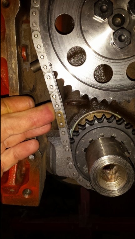

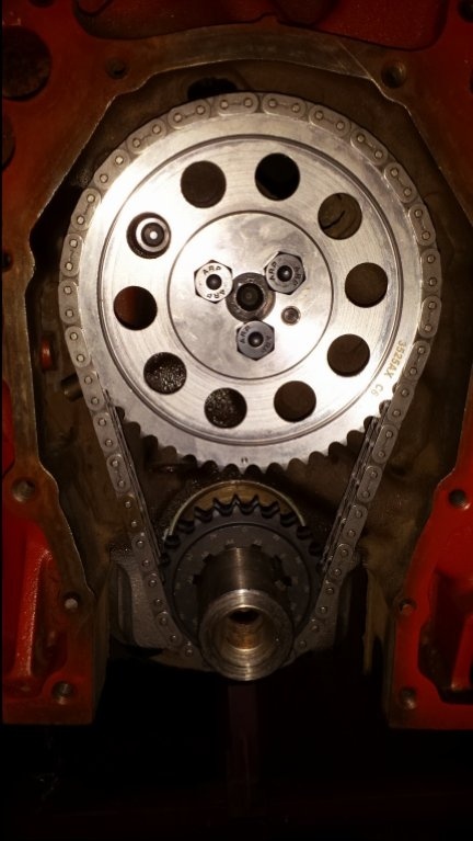

Finished checking my lifters for rotation and went to put on the new timing chain set from Summit so I can degree the cam. Here is the new set... https://m.summitracing.com/parts/sum-g6606r-b
The cam sprocket would not go on with the cam installed. 2 of three bolts would go in but the 3rd was off center. I had to pull the cam out about 3", get the sprocket in place with the 3 bolts, align the marks and tap the set onto the cam/crank snout. Pushing in on the chain with my finger yields about 1/16" give, 3/32" at most. Seems strange to have to pull the cam out to get the set on. Suggestions? Am I paranoid?

Tension sure looks right. I've had a couple of sets that took a little "wiggling" to get the gear on to the cam. See what others say.

Walked them both back at the same time, cam sprocket was a touch low for it to bolt up. With the cam pulled out and sprocket bolted on, slid both sprockets in together tapping with my palm. Cam slid on back with some palm taps.
No retainer on RB, flat tappet sloped lobes pull cam back against the block as well as the intermediate shaft worm gears.

I know tight is good but I wasn't sure if there could be a too tight while still able to bolt it up. It is a nice set for the price and has 2 degree increments for adjustment.
Once you get your bolt back, rotate the motor by hand, checking for any binding at the chain. If none, it will go. Yeah, it's a fairly tight fit.

It seems rather tight to me just based on your pic. Have you tested it based on the factory service manual to check the limits?
That Summit timing set isn't too bad for the price and has only one serious flaw that I have found. The cam sprocket has a great deal of proud metal on the teeth that should be removed with a jewelers file. The machining operation was done in one direction on the teeth and pushed sharp edges to one side of the teeth that will be worn off as the chain passes over the teeth during operation. Those pieces of metal could be picked up by and passed through the oil pump before they are removed by the oil filter. Of course its not only the Summit set that has this problem as most of the non-hardened billet steel cam sprockets will have this same proud metal left during machining.
with everything connected i would rotate the crank/cam and check for that the tension remains equal on the chain during cycling. if not, then one or both sprockets are not concentric.

The only mention of it I saw in the service manual is to replace if deflecton reaches 3/16".

You do understand that a finger test is NOT deflection, right? That is by movement by placing a scale next to the cam sprocket and and rotating counter clockwise with a certain torque(head on, head off) to measure deflection...It is called Stretch...I would think you may be OK but if it is too tight wouldn't that lead to premature wear of the front cam bearing?
If its too tight he never would have got it on.
I never had to pull the cam out in order to get a timing chain on....Furthermore, I hope that bearing did not get nicked/scored when it went back in.....
He probably didn't "have to" pull it either, but he did. If the chain was to tight he wouldn't have got the cam back in.
