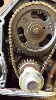

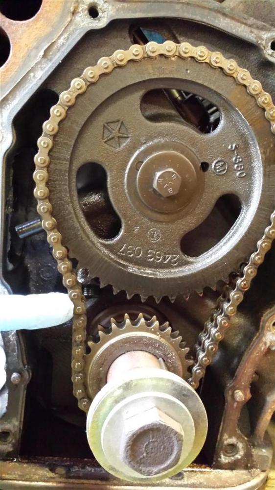

I'm thinking this is too much play.
Measures 1/2 to 5/8 inch deflection.
77 stock 440.
Thanks.

The manual says that if there is more than 1/8" movement (backlash) between the cam and crank, you need to replace. I say; you have the cover off, there seems to be a lot of slack, now is the BEST time to do it.
X2. Parts are cheap, labor is timely and expensive. Just pony up the coins and replace it, IMO.
Just remember to either cut a replacement gasket for that portion of the oil pan, or goop it up good with gasket sealer. I forgot to do that and now I hate myself for it! Good Luck
I gotta admit thou. If the rest of the motor is as clean as that gear & chain, that motor's in super shape for a chain that trashed.
already torn down R&R time
For a stocker truck / motorhome, that would be just fine for a long time.
For a performance car, I'd change it just because it's apart and cam drives don't cost much. This would be an EXCELLENT time to degree the cam.

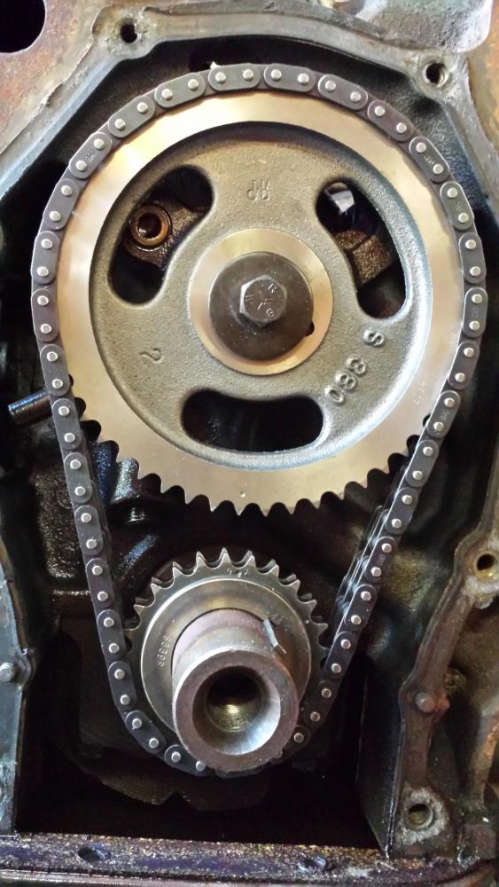

The new chain is tight. The old one was sloppy. Thanks.

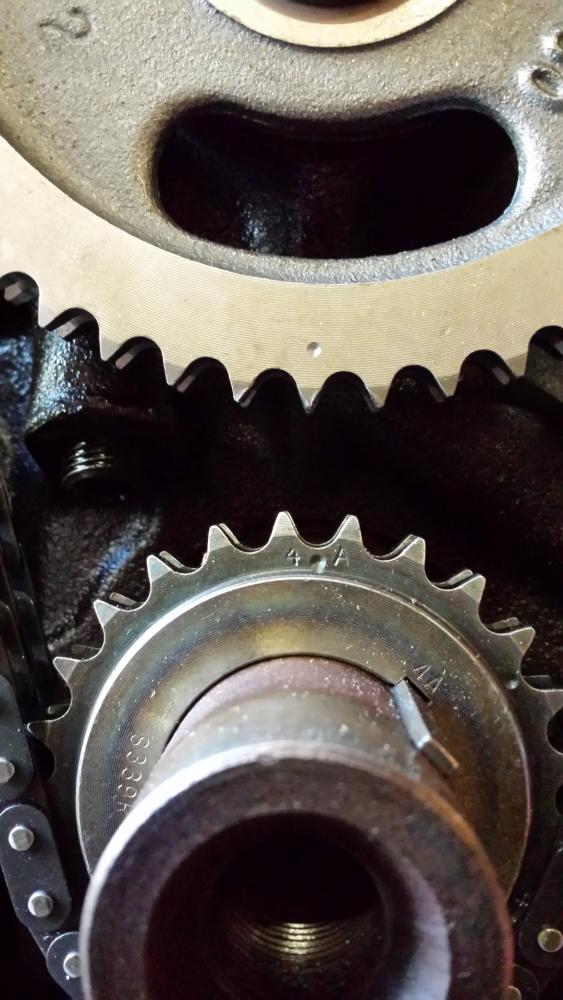

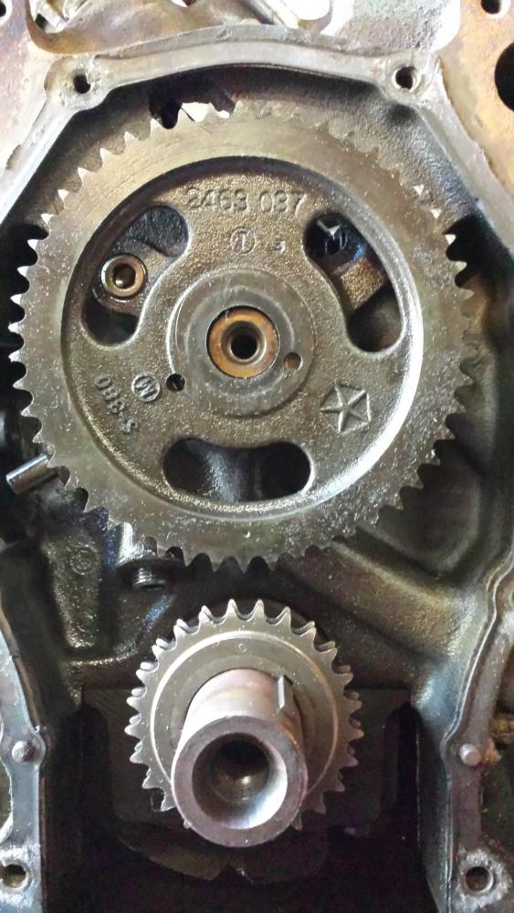

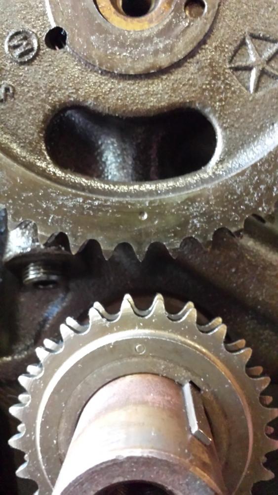

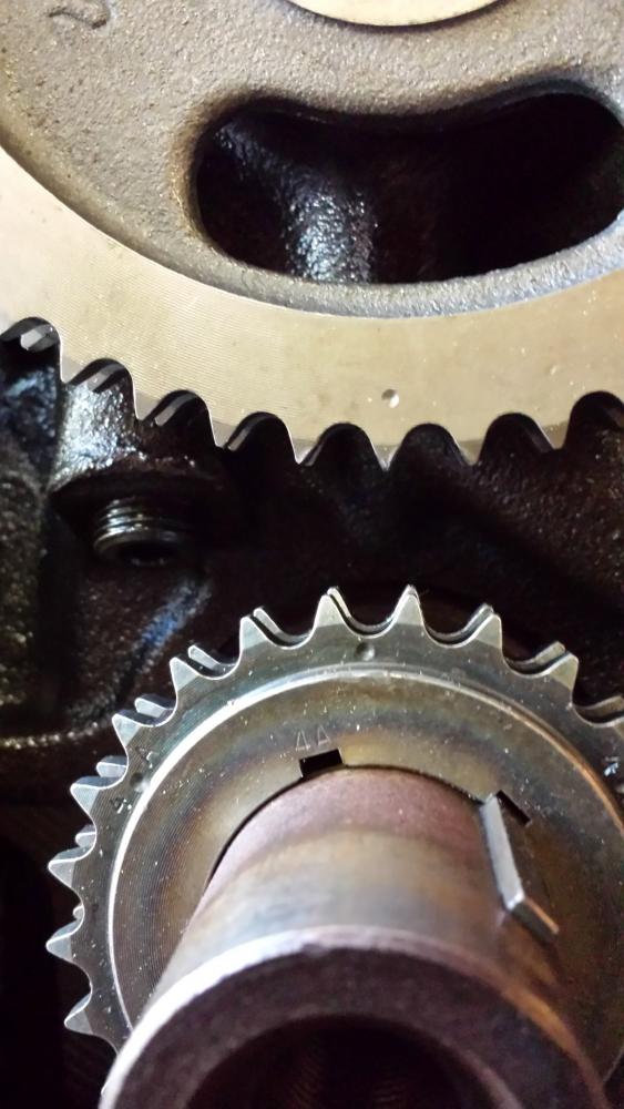

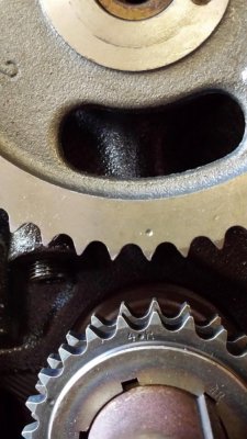

Here’s were I am.
This is a stock 77 motor home engine so I’m thinking maybe the camshaft is different.
I lined the marks up on the original gears. And had equal slack on both sides of the chain. TCD on the correct stroke.
I want to just put a new set on and not mess with degreeing the cam or anything fancy.
When I try and put the new set on, the “advanced” keyway seems to work best.
It slips right on.
But if I try and use the middle keyway (the “0” one) the cam sprocket doesn’t even seem to want to go on the cam easily like it does if I used the “advance” keyway.
The next to the last picture is the "0" keyway with no chain just to show where the actual marks would be if I can get the cam sprocket on in that position.
The middle keyway ("0") also doesn’t line up the timing marks as well as the "advance" one does either.
And the "retard" doesn't look so good at all. (Last picture)
What I wondering is if this original set was set up different with an “advance” built into it since it was a motor home cam?
I'm wondering this because the original marks line up so good. But I have to use the "advance" keyway on the new set to get that close.
The paper work says that advancing it will give more lowend torque.
In other words maybe the motor home cam used a different timing set than a car engine.
Which one should I use without more work since this engine may need rebuilding once I get it running anyway?
I’ve got no problem with using the advanced keyway since this car is just street use.
I just want to get the motor running.
Thanks again for opinions.

AH HA!
I think I figured it out.
I compared the two crankshaft sprockets.
The relationship of the dot to keyway by teeth on the old crankshaft sprocket is the same as the keyway to dot by teeth on the "advanced" marking in the new sprocket.
The "o" and the "retard" marks teeth placement is different from the old sprocket.
(Or is the "tooth". Whatever)
So I use the "advance" keyway on the new sprocket.
