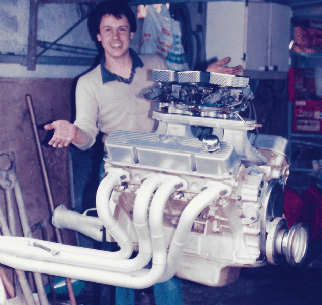

Me with my first 440 ... built it in 1982. It turned out to be a great street strip motor! Used the Direct Connection bible and other books to guide me.
