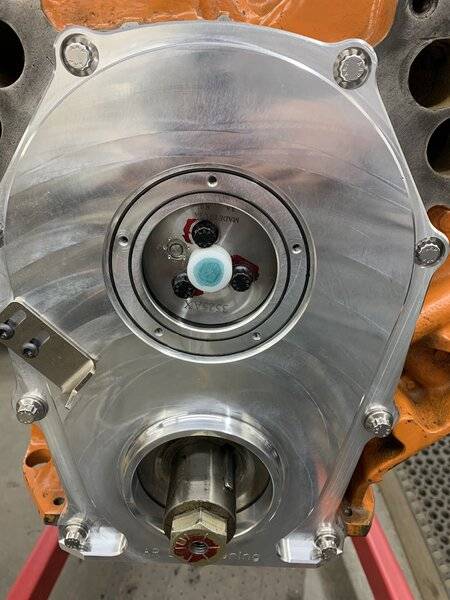

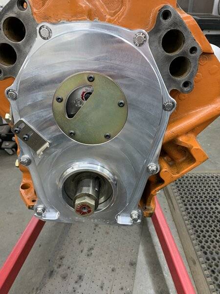

,Ill be buying and installing an ar engineering timing cover and roller button set up,wondering if andy is on here ,Does anyone know of any companies selling Mopar bigblock timing cover gaskets in different thicknesses,need any between 026 and 031 or either of those 2 thicknesses,if andy is on here can you message me please,thanx
Superperformance
To shim up a roller cam?
no,i will be using the ar engineering cover that is stock thickness,they claim with a031 gasket my button will be at 010 clearance,I want a few different thicknesses to adjust it where i want it
Andy's a member here. Haven't seen him in a while though. Good luck on the search.
Superformance gaskets are too thick for what your needing a regular standard paper gasket is in your thickness range. I have one of Andy’s covers and a roller cam in my hemi and not that the roller buttons are bad I would recommend using a comp nylon button and you can use superformance gasket or whatever gasket you choose and just set the end play where you want by filing down the button.

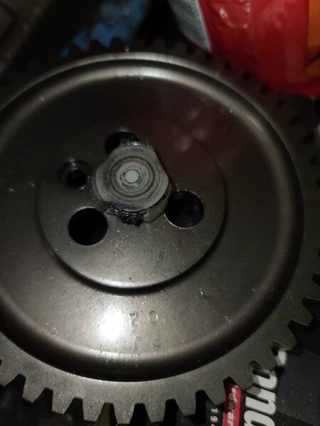

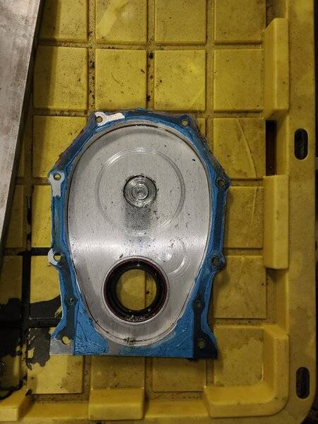

I used a comp nylon button, it required clearancing around the 3 bolt cam and fit kind of loose in my Hughes roller but I thought it was ok after measuring/setting my clearance.
I dont think it fell out when reinstalling my aluminum cover, but the slop in the boss of the cam & the dowel allowed it to work its way out, but it caused a major failure and allowed the cam to walk forward and chew the backside of the cover.
