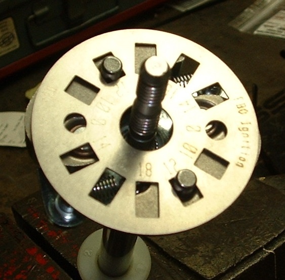

Mr Frank, here's a very handy little device you might want to try.
http://4secondsflat.com/Mopar Mechanical timing limiter plate.htm

Thank you for the clarity. Much appreciated. And I promise to call it a distributor going forward. I'm going to try a few initial settings tomorrow starting at 18* and increasing a degree or two at a time. What do you think of those FBO Systems Limiter Plates instead of welding?
http://www.4secondsflat.com/Mopar Mechanical timing limiter plate.htm
That looks like a great alternative to sending it out for welding. Have you tried this device yourself or heard any feedback on it? I'm going to do a search and see what users have to say. Thank you!
Yes, I'm using one now in one of my cars. MUCH better solution than trying to get the slots welded and ground to the proper size. Very easy to install also. I plan to install one in all my cars when/if needed in the future.
I have one in our 68 points distributor. Pretty slick product. I was basically having the same issue, lots of base timing them total timing was way out there. I definetly had a ping.
