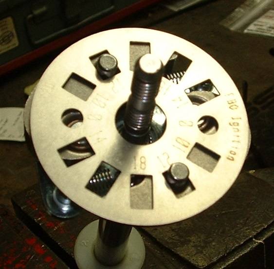

Stock style distributor requires taking the plate out and welding up the end of the slot. Putting back in and seeing what you have for advance, pulling, filing, etc. I did one with JB Weld years ago and never had a problem with it.

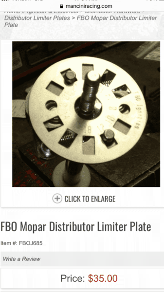

I used one of these to limit the amount of advance. I’m not familiar with the Mallory distributor.

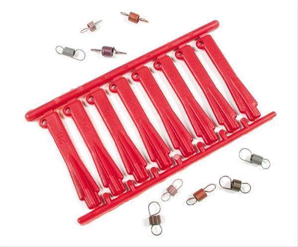

here is the adjusters needed I talked about
