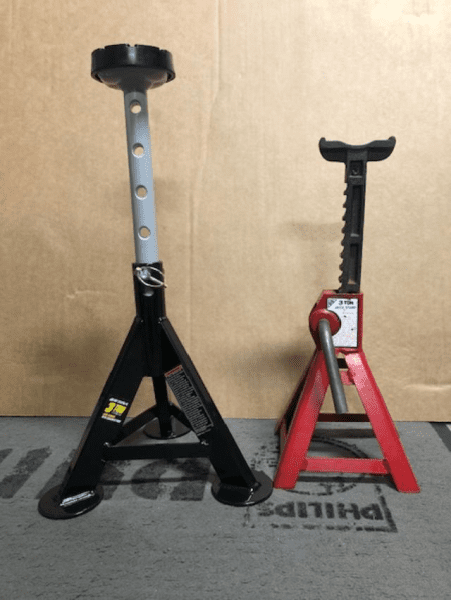

1. Get the car up high enough to operate effectively. I put drive up ramps under the front wheels wheels and purchased these tall sturdy jack stands from Harbor freight to hold up the rear frame in fromt of the axle. I let the axle drop all the way down for easier access and put a second set (shorter) under that as additional safety (I first raised the car, secured with stands then raised again usinf a 4" x 4" block fore additional height):

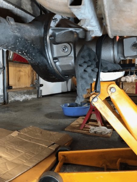

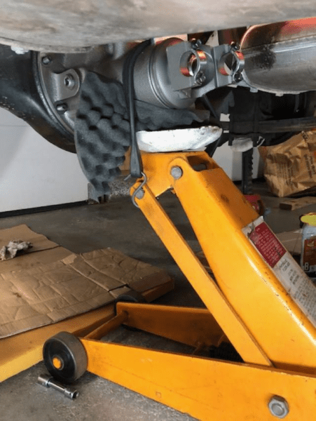

2. I put the 3rd member on a foam pad and used a heavy duty bungee cord to strap it to my floor jack (my old jack has a nice size dish cup) then rolled it under and could adjust the height with only the bottom half of jack handle. It was still a struggle but doable and much safer than trying to bech press it up and in:

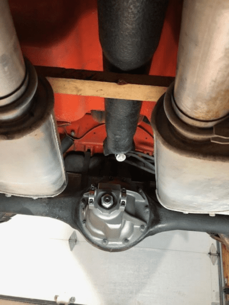

3. *Tip I used a 1" x 2" strip of wood to hold the driveshat up out of the way above the mufflers:

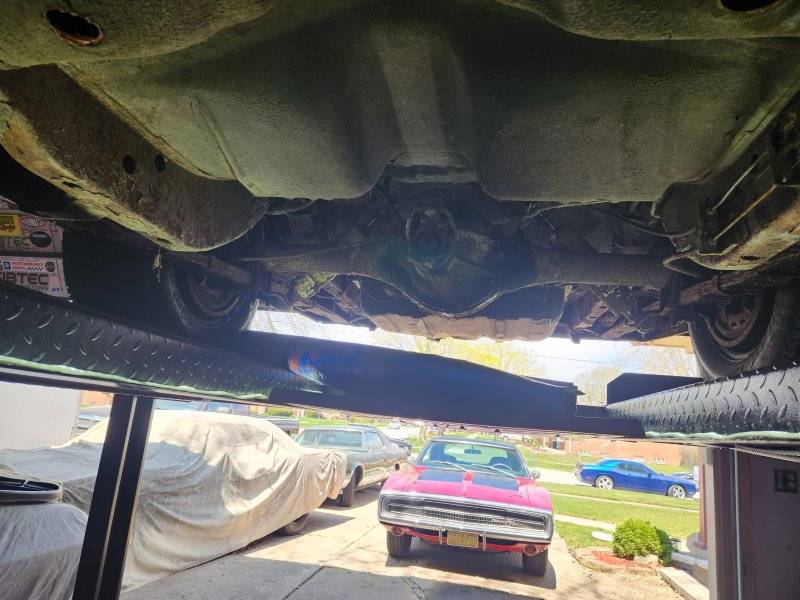

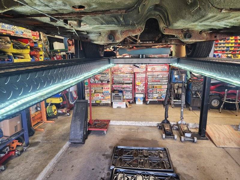

Very true. I have a hoist now. I do have a swap coming up from a 3:23 to a 4:10 someday soon when I get a chance. Looking forward to doing my first swap not laying on my back on the ground.
