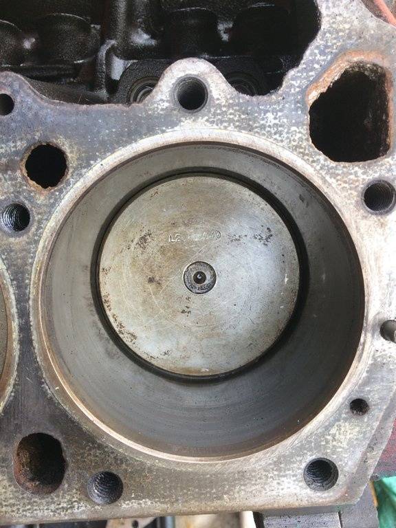

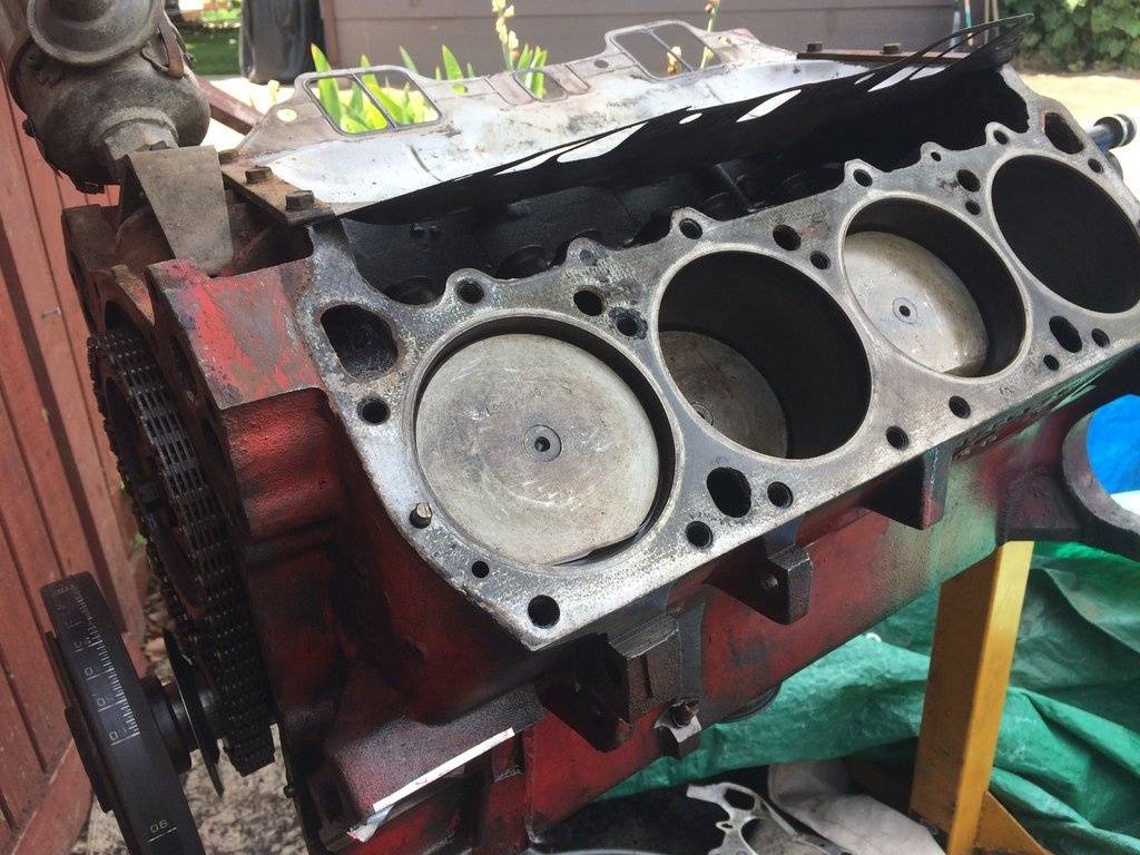

I seek your collective wisdom. I have the 383 torn down to the short block and am starting to get things cleaned up for a new set of gaskets. I've looked around the web for pointers, and many of them suggest 'spraying down the engine internals after clean up'. Spray them down with what? Light motor oil? Acetone? I took a set of heads to get hot tanked once and the guy took a belt sander to the gasket surface to 'clean them up'. Should I do that to the block surface as well? I keep vacuuming and wiping out the crud in the cylinders after each cleaning session, but wonder if, when I'm done, I shouldn't flush the motor by spraying it down from the top and letting it all run down through the motor into a pan on the floor?

To clean the head/block mating surfaces, I use a scraper VERY, VERY gingerly to just remove the gasket pieces & not scratch those surfaces....I'm sure there's an even gentler way. It is critical to have those surfaces perfectly smooth so your head gaskets will seal.
You want to spray down the cylinders with WD-40 (not acetone). The WD-40 just prevents air/moisture from nearly instantly rusting (& ruining) the cylinder bores. I mean, you "could" use acetone to clean it, but follow that up IMMEDIATELY with WD-40 (or motor oil) to just prevent "flash rust".
One way I've done it is to turn the motor over a tiny bit to see which cylinders are headed down. Do your gasket removal/cleaning process on those two cylinders (2 go down at a time), spray with a touch of WD-40 so all the dirt/smutz you just created sticks to the cylinder wall/piston, turn the engine (crank bolt) a bit more, piston moves down, wipe of dirt/smut & repeat. When you do it this will all make sense. You just don't want to have all that dirt/smutz scraping the sides of the cylinders/piston rings. Once a cylinder (or two if cleaning in pairs) is done, immediately re-spray WD-40 to prevent rust.
Also, like 65-440 says, you are literally about a dozen bolts away from a complete rebuild. If you don't have cash for that (I've been there), then at least pop off the main caps (re-torque when done) and rod caps (re-torque when done).... don't switch caps & keep them facing the same direction. Doing this you can inspect the bearings (i.e. good bearings = good oil pressure = long engine life) and if you find any of them scratched up, NOW is the time to replace them. For the pistons/rings...the old "rule of thumb" is that if you can't get a fingernail on the "wear lip" at the top of each cylinder, you can get by without putting new pistons/rings in. (good piston/ring seal = good power). If one/two is bad, now would be the time to re-hone & re-ring those cylinders.
My first engine build was one broken piston (not too bad). I didn't "machine" anything. I bought ONE stock piston & honed that cylinder + two others, but new rings in just those three cylinders & put in a new set of rod/main bearings without machining the crank. It was a "poor-man's rebuild" 383 and I drove it like that for another 3 years & it was still running good when I pulled it out (for a larger, completely rebuilt motor).

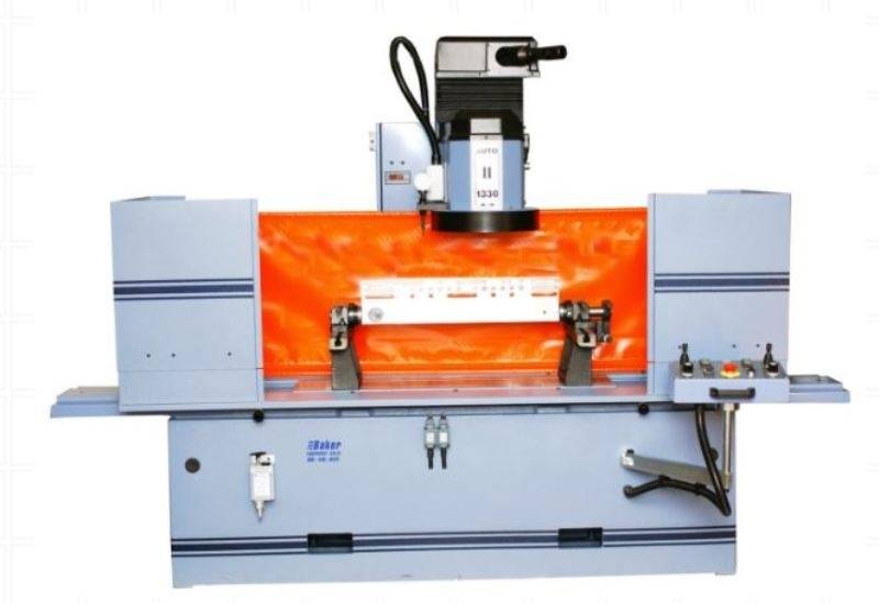

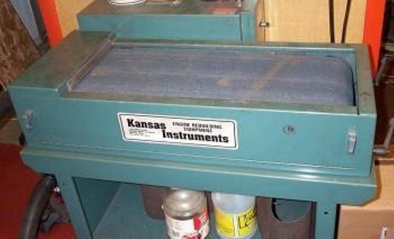

A "Platen Head Sander" is not your ordinary belt sander you get from Lowes or Harbor freight. It is a specialized automotive machine shop tool from the not so distant past.
That being said, I have never wanted to surface heads this way. Stock removal, and squareness to the original surface were not guaranteed in my mind. I have a surface mill and use CBN for cast iron and diamond for aluminum heads. Surface finish is paramount to gasket sealing and gasket longevity.

Thanks for all the input. The 'belt sander incident' was several years ago when I was swapping heads on a GM 6.2 diesel. I thought it was unusual at the time, but didn't know any better. It went back together and ran great until I sold it a year later. It sounds like that method was 'old school' but not recommended. The 383 I'm working on is out of a '64 Polara and was rebuilt at some point as it has .040 pistons. Everything looks really good although the cylinders are shiny and have no traces of hone remaining. The lips of the cylinders have a barely perceptible ridge with a fingertip - can't hook it at all with a fingernail. There was quite a bit a carbon buildup on the pistons and the valves, but it all cleaned up nicely. Looks like the timing set was replaced during the last rebuild, good shape, all steel. Not sure about the camshaft and lifters, but the heads appear to be sporting replacement springs.
