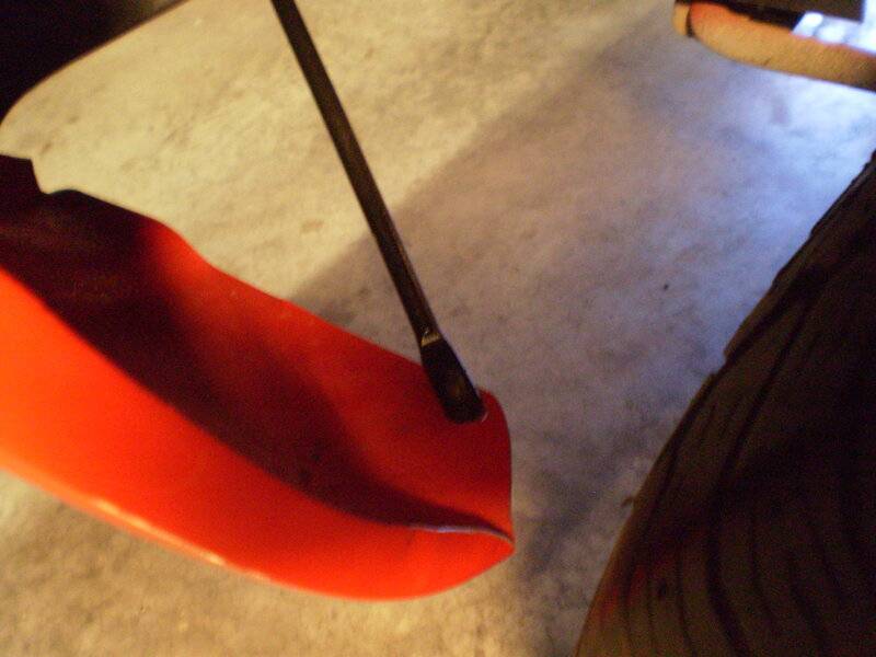

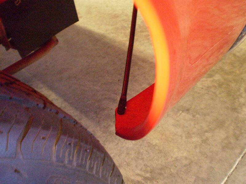

If it's not to much trouble, could you post a picture showing how your fender has been trimmed , If it's a big hassle don't bother. Thanks
I'm sorry, i cant. I'm 250 miles away from my car at the moment.The trimming was from the flange on the splash panel/front valence, the piece that is body color under the front bumper. The actual fender opening is stock.
Here's a couple of shots of lower fronts of fenders on my 1964 Polara that I trimmed about an inch of metal away for tire clearance. Hope this helps.
