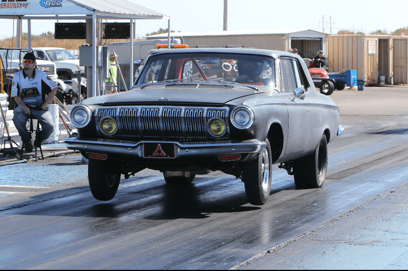

M/T ET Street Pro. 275/60/15.
I drive them everywhere the same way I race them and they pull double duty amazingly well.
1.36 60 ft. in my 3,600 lbs. car.
Make sure you have 1350 u-joints...

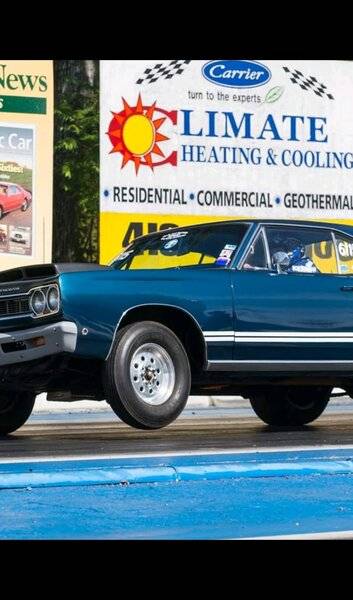

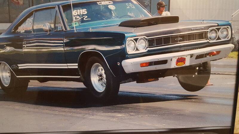

I had decent luck with 315/60 x 15 MT's drag radials
but they aren't worth a **** in rain or cornering
I went 8.58 @ 156 on a set over a 5-7 year span on juice,
9.70's @ 135 N/A in a 3520# car my old silver & black 68 RR
But;
I only lived 12 miles from the track too (Sacramento raceway)
I did cruise it quite a bit too, 10k-12k miles worth
I kept the tire-smoking limited to the track, tires are expensive
especially racing tires
the p295/50/15's Radial T/A's do a great smoke show too
they handle way better than the drag radials do too, far better
