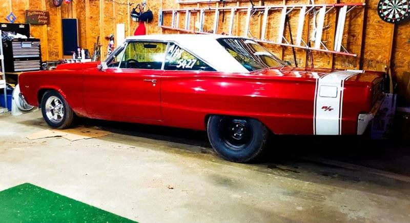

I'm in the beginning stages of building a 512 low deck stroker for my street-strip 66 Coronet. I'm hoping to get some input from the wealth of knowledge that I see every day here in the race forum on B Bodies. The car sees limited use on the street, never gets more then 40 miles from house. Race track (BIR) is 7 miles from my house and I drive there when I race. My goal is a 11 flat, high 10's ET car. My 3750 lb car is set up with Hughes competition manual shift 727 with trans-brake, 9.5 inch 4000 stall street-strip converter, 4.10 rear gear, SS leafs, Calvert adjustable rear shocks, 28.5 MT 10 inch drag radial. Subframes are tied together, 90-10 Calvert shocks up front. Fuel system for the track is a 8 gallon fuel cell plumbed with QF electric pump and 8an steel braided line up to the engine compartment running 105 octane gas. My plan for the low deck 512 is a 440 Source kit with 11.5 cr flat top pistons, ring gaps will be set for mild nitrous shot, 78 cc aluminum head that will flow 265 on intake side, solid lift cam with 288 advertised duration, 615 lift, 1.5 roller rockers. Trick Flow single plane intake. Fuel delivery will be a Holley 900 cfm Sniper XFlow fuel injection system rated for 800 plus naturally-aspirated horsepower. Spark is from a MSD 6 digital box & MSD distributor. Looking for input, too much cam? Not enough cam? Does anything stick out as a bad idea? Only other thing I will add is I have a narrowed Dana 60 which will be installed when I do a mini-tub and move the springs in but that will be at least a year out. Thank you.
My 66 Coronet was a 505' (Only .030 over, not .060 over to make it a 512"). I used an Ohio Crankshaft Assembly with their H Beam Rods and their SRP supplied forged pistons with 12.2-1 CR. (you could go 11.75-1 probably and not lose much and might be easier on pump gas), Motor had 440 Source Steel Billet Main Caps and 440 Source Girdle.I had Comp Flat Tappet cam with about .650 lift. 440 Source rockers with 1.6 ratio. INDY Max Wedge heads ported to 340CFM from the regular CFM of closer to 310CFM. Dougs 2" headers with 3.5" collector. MSD Dist, of course. Indy single Plane 4500 Intake with 1050 Dominator. MSD 6AL box. Dana 60 with 4.30 gears and Hoosier 29.5 tall,11.25 tread with Bias Slicks. Calvert springs, bars and 9 way shocks and front 90/10 shocks.
5000 flash converter to my A&A Torqueflite. PRETTY BASIC STUFF. Ran consistent 10.15 and 129+ but as low as 10.04 @131+ with some good air. Ran 110 race gas at the drags.
And....absolutely streetable, drove it to car shows and hot dog stand get togethers all the time (thru Flowmaster Mufflers).
With the ET's and MPH my car was running it had to be making about 750HP.
When I originally built the motor it made 602 HP but had standard port (not max wedge) heads that only flowed 290CFM. I also had 1 7/8 Hooker headers, INDY dual plane intake with an 850 Demon carb....it ran 11.00 flat.
With the head, intake manifold and carb upgrades it went 10.04.
YOU DO NO NEED NITROUS TO DO WHAT YOU WANT.
Go with Max Wedge Heads, bigger cam, big headers, Single Plane 4500 intake and 1050 Dominator to start...don't start smaller and then spend the money to upgrade later.
I guarantee your car should run below 10.25 with this build similar to what mine was. I did all the planning for you when building and testing my car...no reason for you to build the lesser motor you described in your post above.
PS: don't worry about running a 1050 Dominator on the street, it runs just fine...no need for the fuel injection system. The Holley 1050 Dominator SP carb is only $810 on Summit.

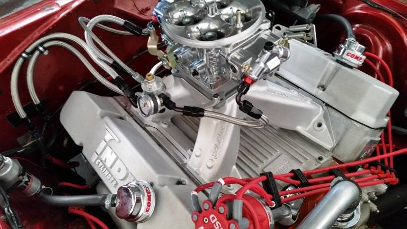

My Satellite is pretty much the same. My 512 has a little more CR & Max Wedge Indy heads. Some cam suggestions to give to the vendors.

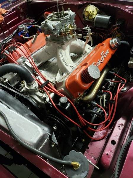

I'm running a 512 in a 66 Coronet. 12.4 compression, hughes 268/272 solid cam, hughes 1.6 rockers, trick flow 270 heads, Super victor intake and a small 850 carb. 2in TTI headers, 3in exhaust.
Ran a 10.46 at 129 first day out. Use pump gas for street and mix 110 50/50 at track. Very steetable and fast motor. Can't wait to put the 1050 dominator on it. Chassis is pretty much same as yours, Calvert everything in rear 90/10 in front. 3.90 gears, 4200 stall, 30in tall tires. What a blast!
